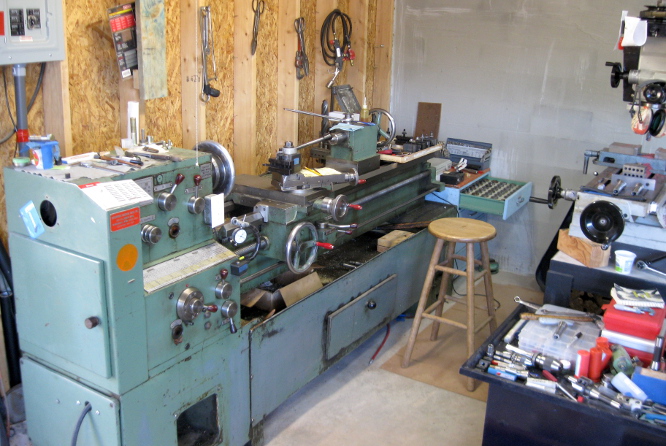

Ridgeway is correct about this, I can't say I've ever heard someone saying that a lathe is too large. Like gunsafes and garages, whatever you think will be enough, double the size. I know for what I usually do what I have is overkill, but it's nice to know that if I need it, the capacity's there:
17x80 gap bed, gear head lathe. 40-1800rpm + VFD speed control
