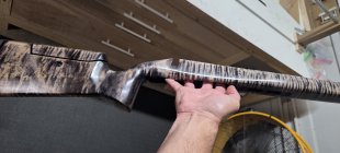

Mix a batch 70% black with 30% medium brown 1st coat, 2nd coat reverse color ratios. 70% brown 30% black
Here's a couple test panels I'm working on for a customer.
Trying different application techniques and not sanding between colors using straight dye undiluted.
Red orange vintage amber to natural fade, copper burned in on bottom with a kiss of brown n black lower edge
View attachment 1608349same colors used only i completely covered in red and sanded back leaving the red in the soft grain.
Faded up versus lengthwise View attachment 1608351View attachment 1608352
Bottom one

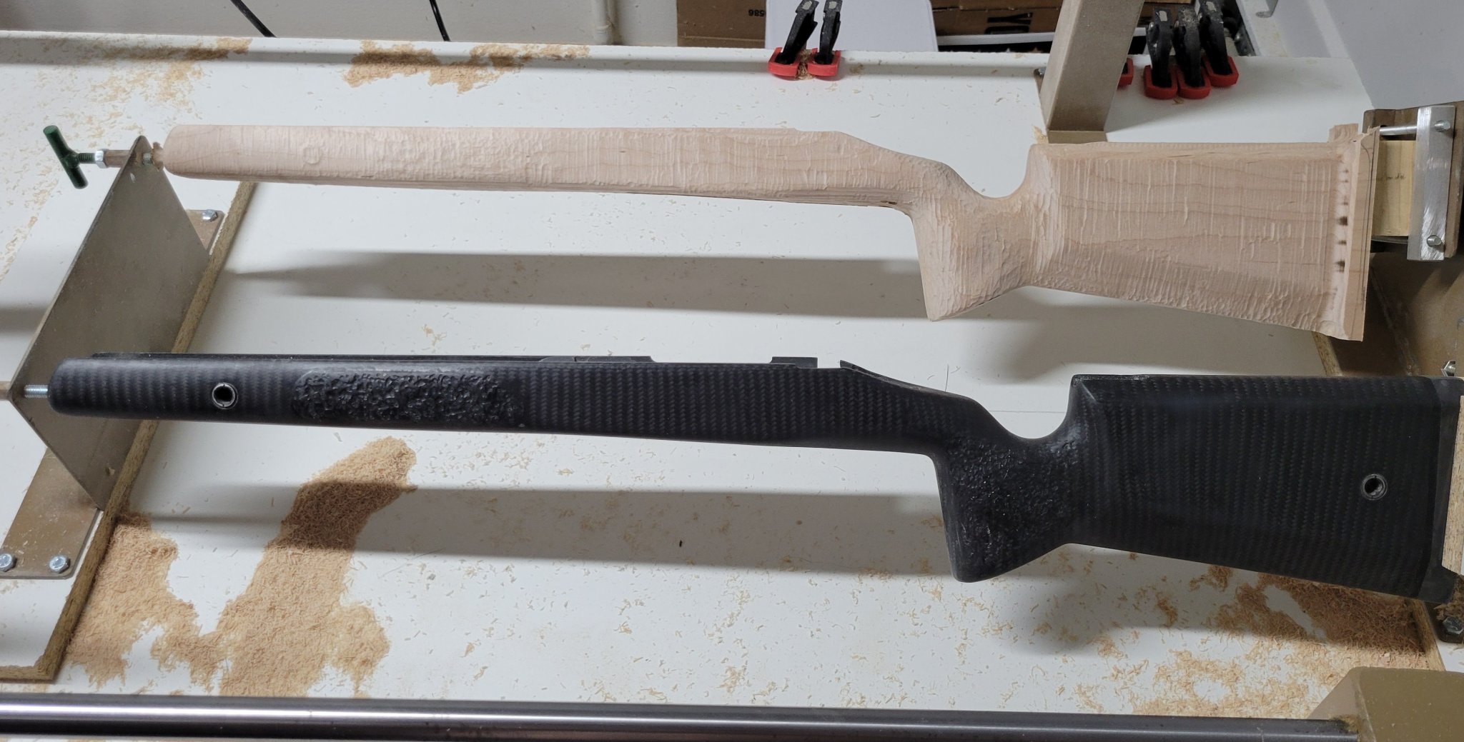

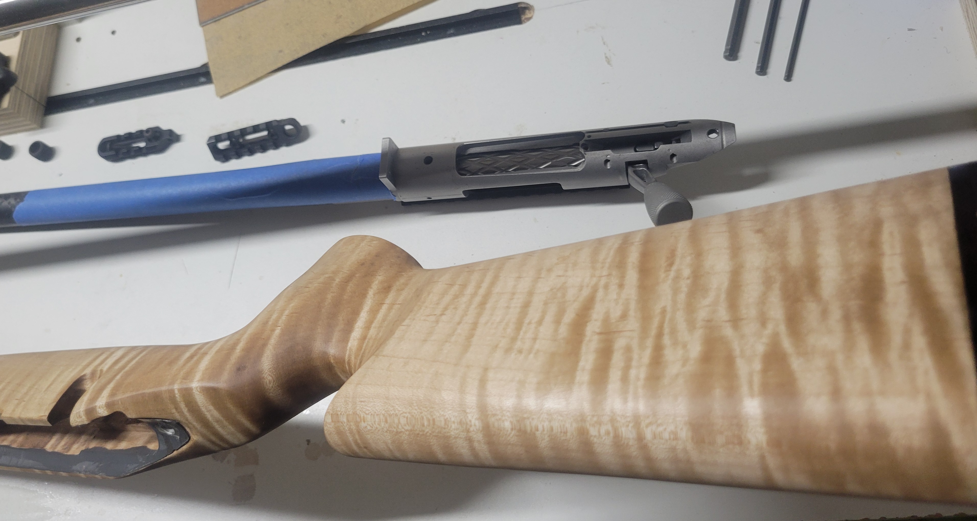

ROUND 1 - Target / Bench Rifle
After 10-12 years of shooting aluminum chassis and stocks made with some sort of composite, I felt it was time to get back to wood.
Maintaining the form, fit, function of more modern stocks was important, but I wanted to gain the warmth, feel and beauty of wood.
I looked around and didn't see what I wanted, so I decided to make it myself.
The Process:

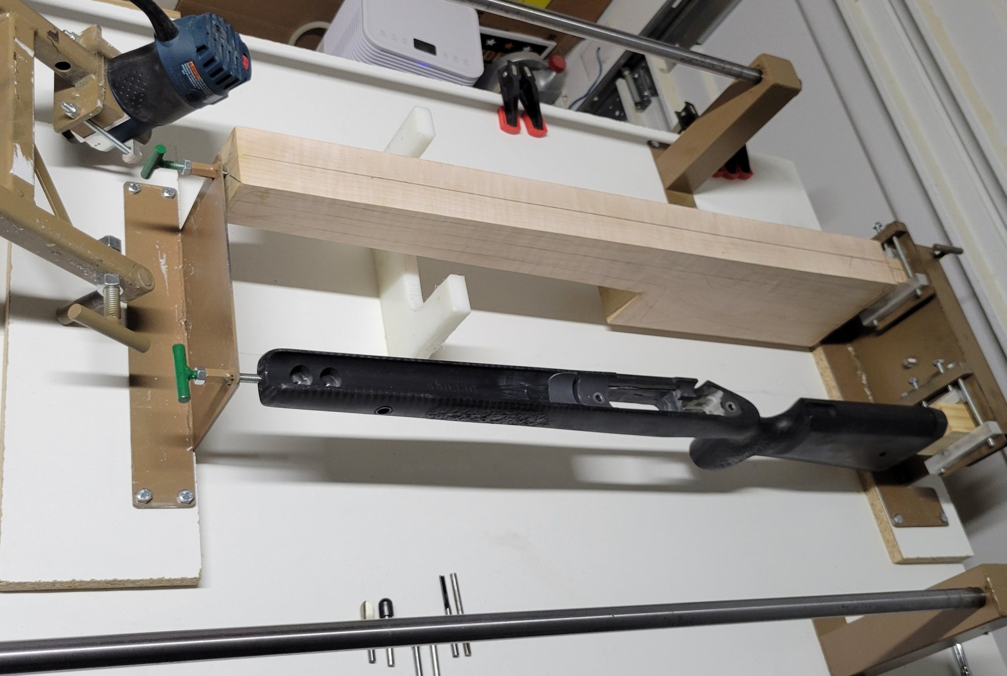

- Source curly maple blank

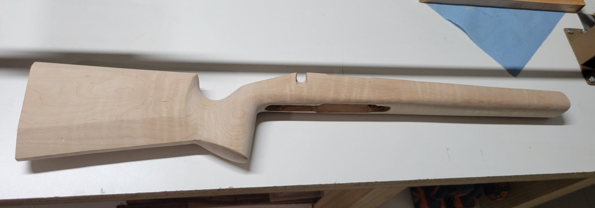

- Carve (rough pass) with router
- Contour and smooth (fine pass) with router

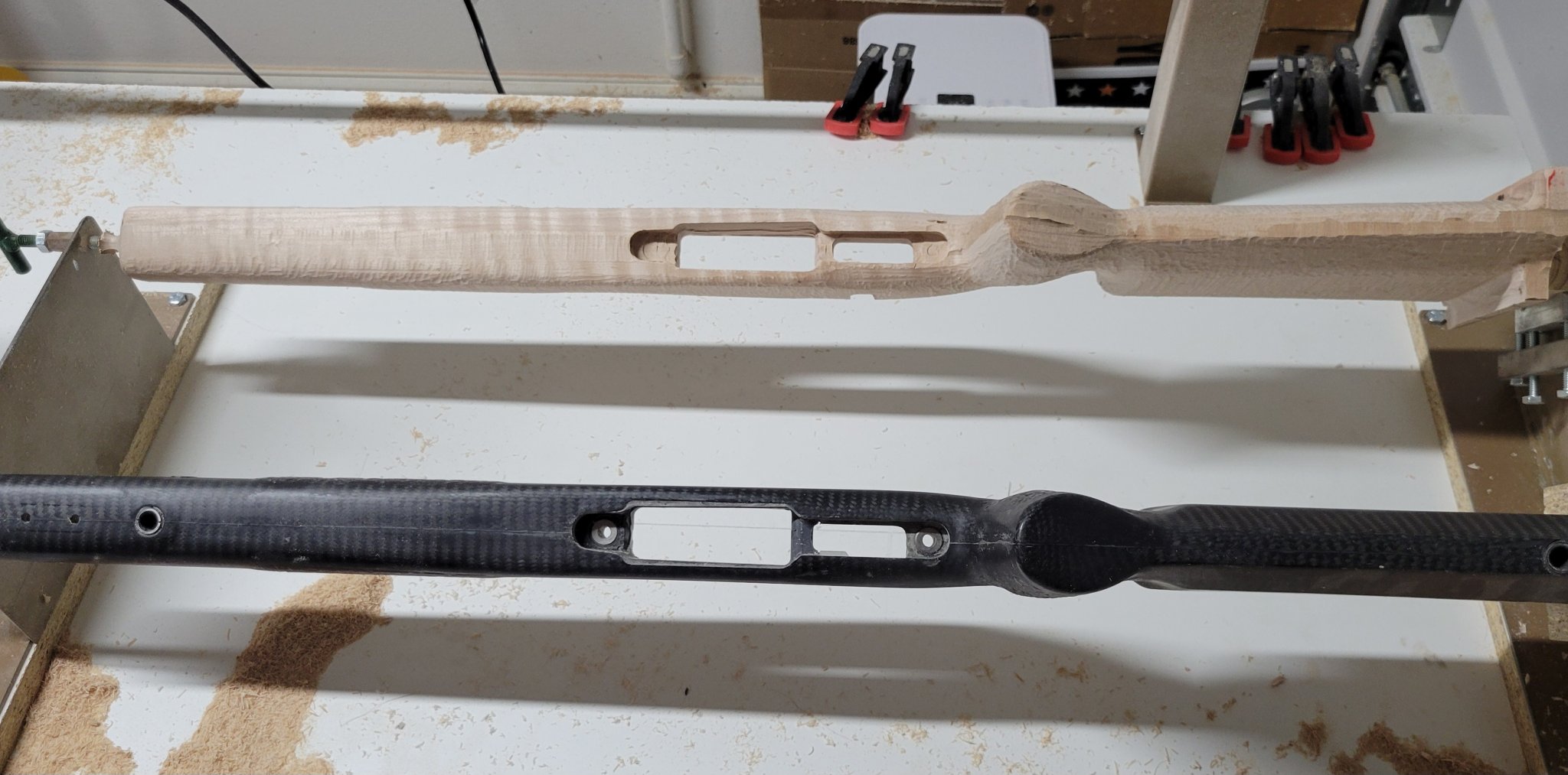

- Cut the inletting (action, bottom metal & barrel channel)
- Sand... there was a lot of sanding!
- Fit recoil pad with belt sander

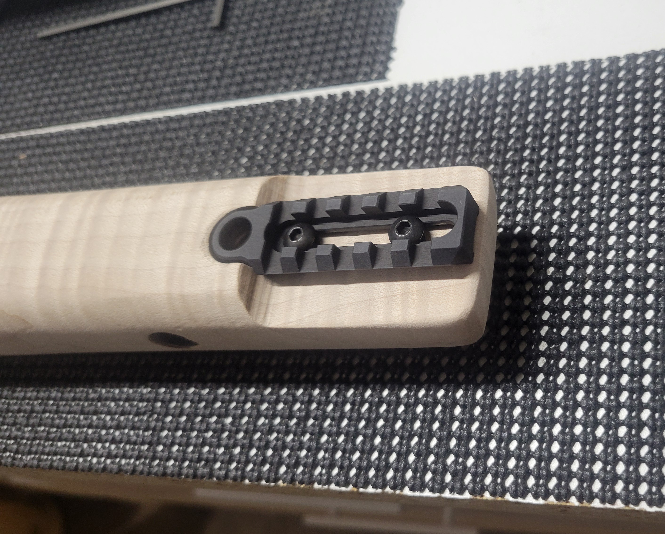

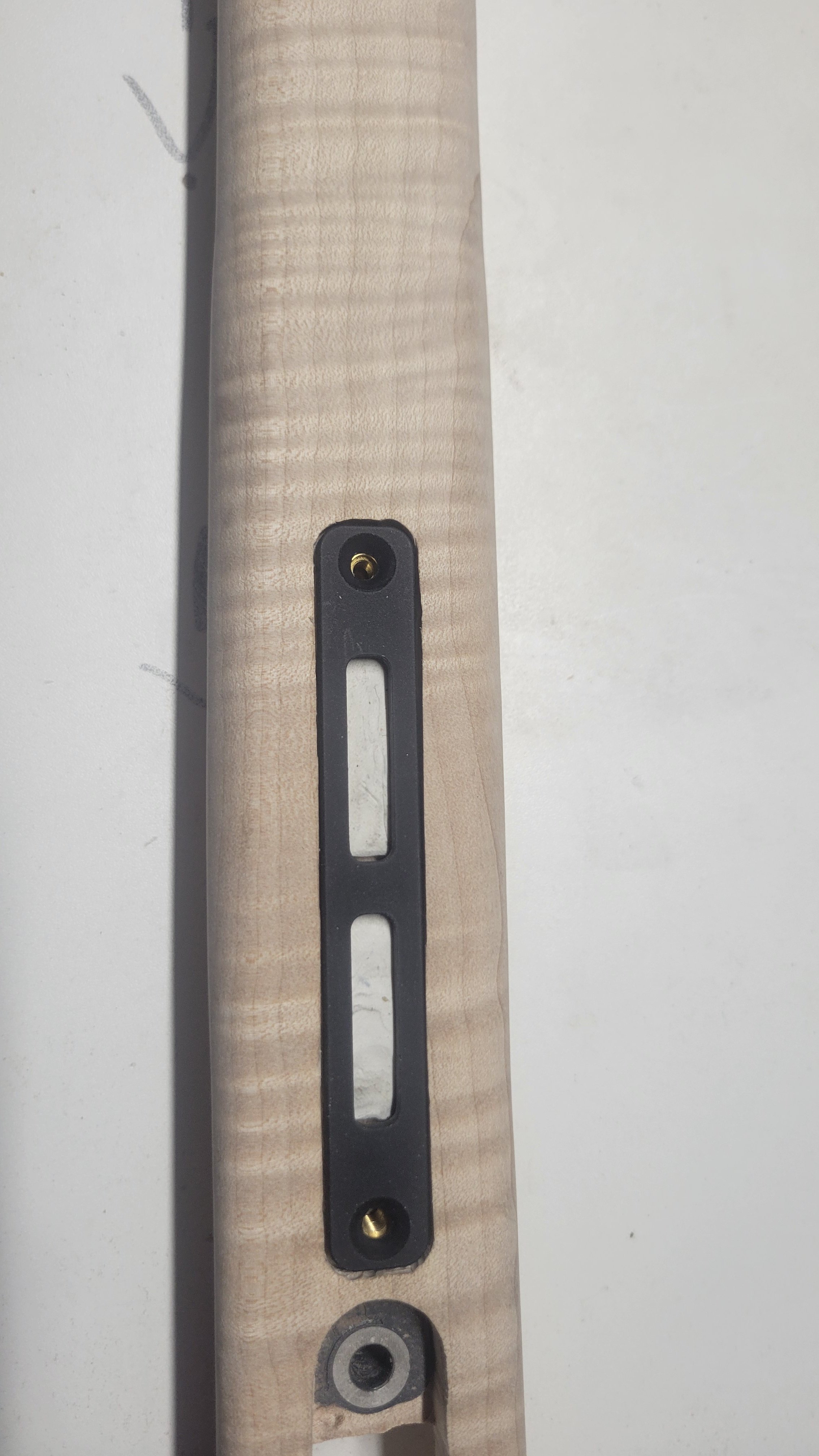

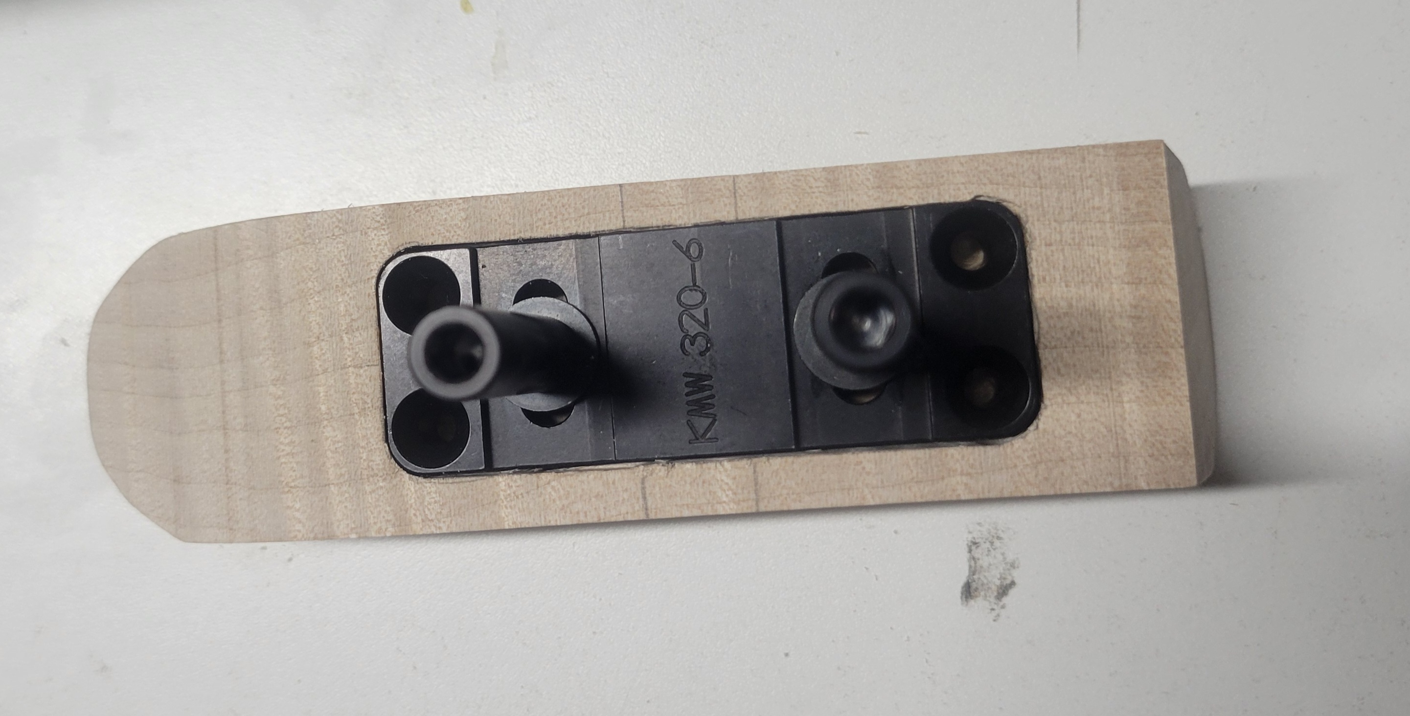

- Add picatinney rail for bipod (drill and counter sink t-nuts)

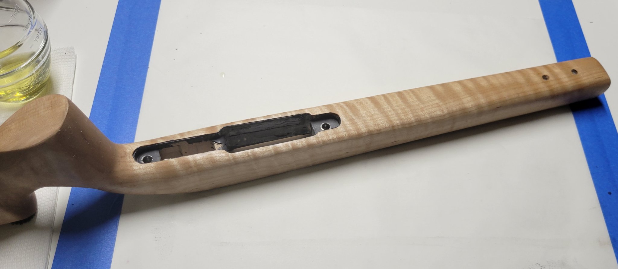

- Drop in pillars (checking action/bm fit, alignment & feeding from magazine)
- Epoxy bed action & bottom metal
- Apply tung oil finish (2 coats cut 1:1 with mineral spirits for deeper penetration, 4 full coats)
The Results:

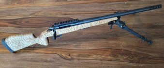

ROUND 4 - PRS/Competition Rig
Origin SA
Competition Bolt Knob
Proof Comp Contour 223, 26" threaded 5/8x24
M5 Bottom Metal
Triggertech Diamond, Flat

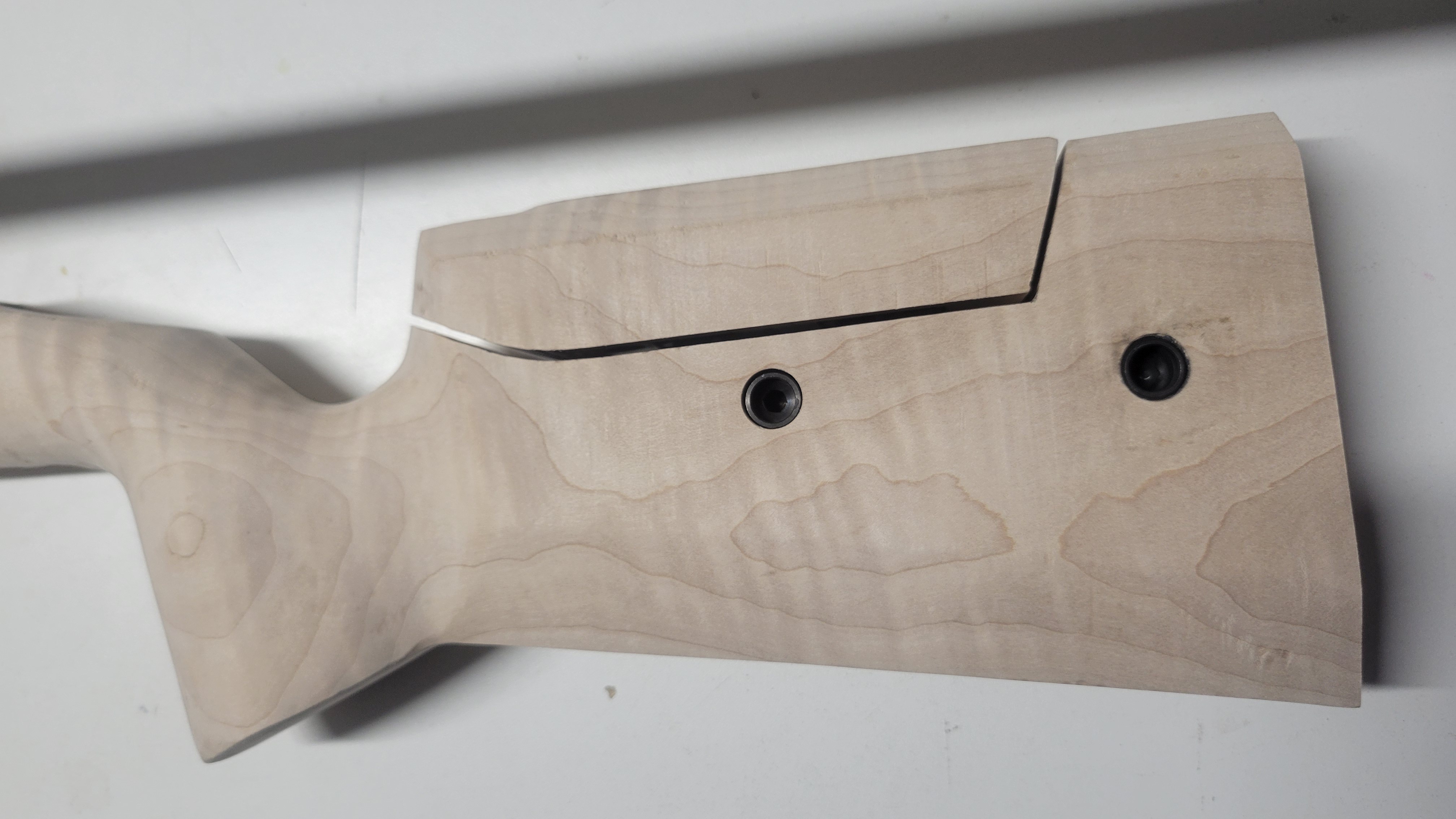

Custom Curly Maple - Adjustable,
Pillar and epoxy bedded
Freebore has the 77gr SMK at 2.390 to touch, and the 80.5gr Bergers at 2.520" while keeping the bearing surface above the neck shoulder junction.
Should be great for PRS tac class with 75 ELDM or 77 SMKs, then you could run the 80.5 or 85.5 Bergers in Open division.

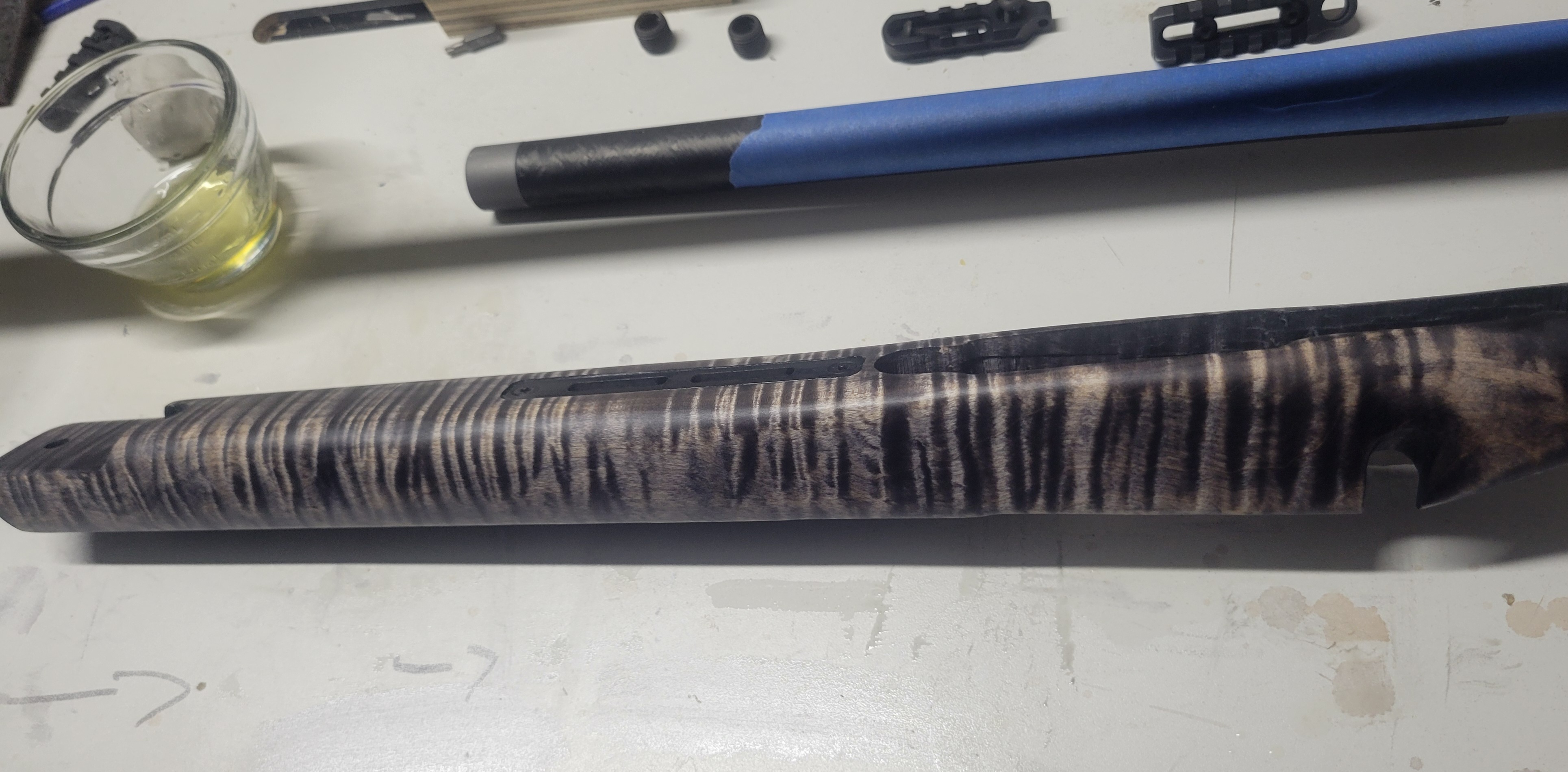

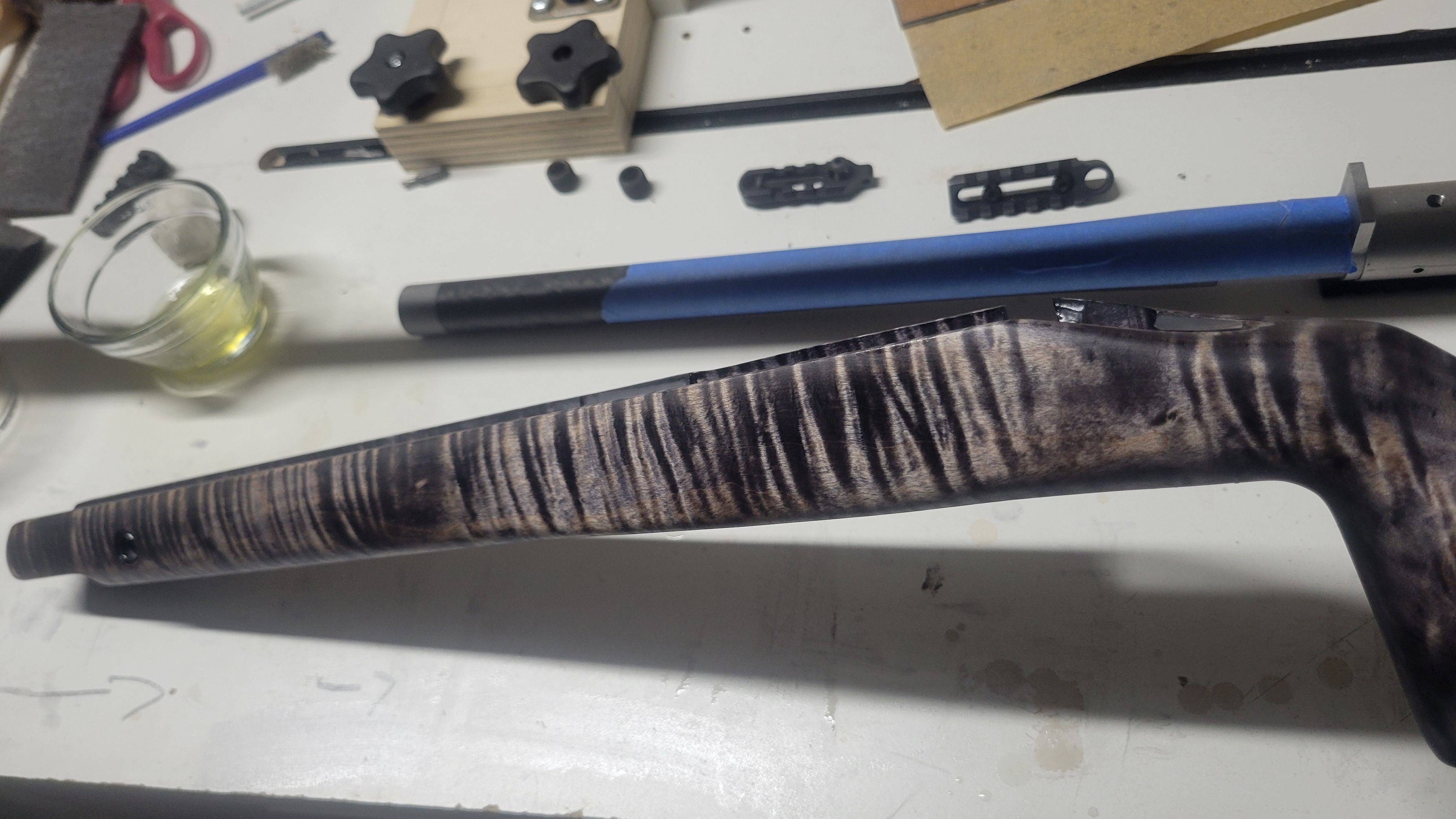

Stock is almost done, I should be able to shoot some groups Friday.
Black with subtle fade to silver to compliment the black action and stainless barrel.

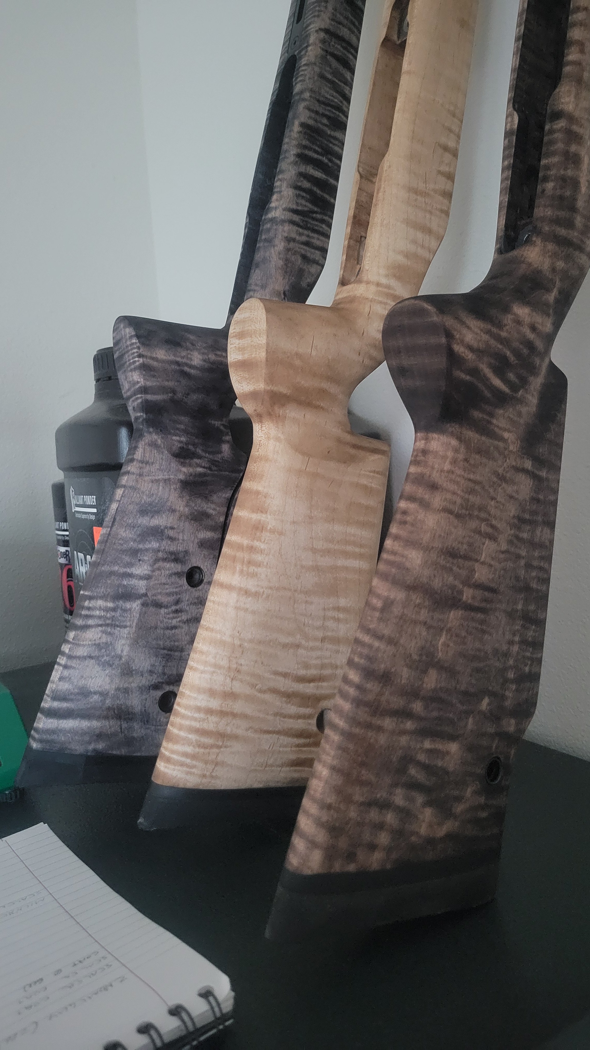

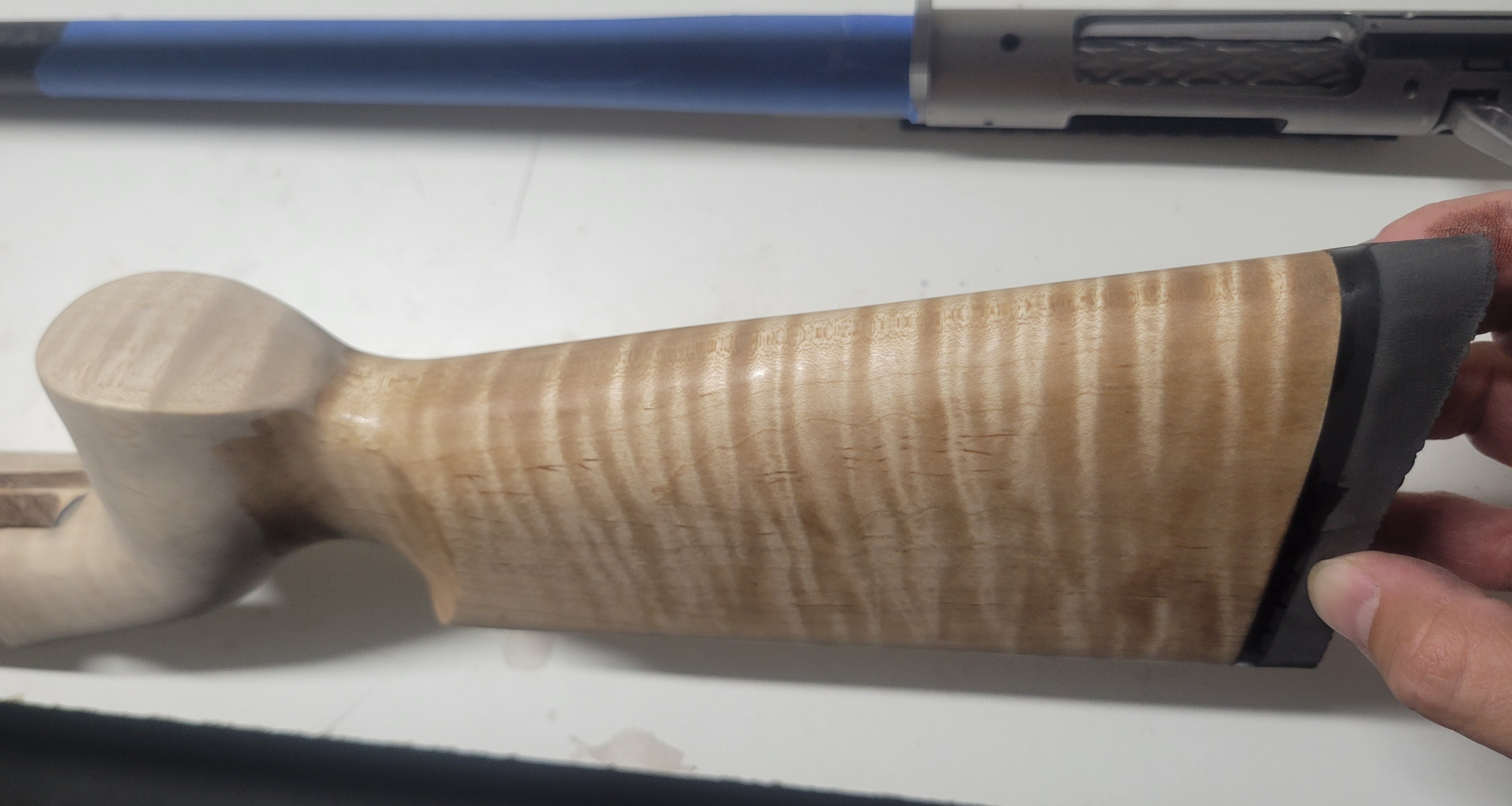

Work in Progress:
These need about a dozen coats of oil before being considered complete, but wanted to show some design and color options I've messed around with.
In the light, this almost looks like a marbled tiger...
A nice natural option with some contrast in the curl...
