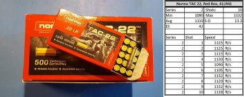

Thought I would contribute to this thread by posting my evaluation of the new red box Norma TAC 22 at 100 yards.
Rifle / Range / Target
I shot the 50 @ 100 with my Walther Running Target rifle and a Balvar 6-24X40mm scope. I shot this at my home range, off a portable folding bench with a Caldwell front rest, Protektor front bag, and no name suede rear bag. Elevation to my 100 yard target is about 100' higher then my shooting point, thus the need for the attache case under the front rest. I shot at a Birchwood Casey 8" Hi-Vis target. It is composed of a 1 inch center aiming dot surrounded by 1 inch rings. The target was attached to a white cardstock backer to facilitate accurate measurements.
Shooting conditions were good. Temperature was 70 degrees with a steady 5-9 mph 4 o'clock wind.
100 Yard Range
Ammo
As stated, I tested a box of Norma TAC 22 from a case I recently purchased. The case is lot# 41LR41. The listed velocity is 1083 fps. I did not chronograph the 50 rounds I shot because my Magnetospeed V3 attaches to the barrel and I did not want to risk changing the barrel harmonics. However, I had measured 10 rounds from the same lot/brick a few weeks earlier. My measurements at that time were: Average Velocity - 1119 fps, Extreme Spread - 42 and Standard Deviation - 13.3
Results
Results were good and seem to correlate to my earlier chronograph measurements. The 1 inch aiming dot was obliterated and all 50 shots grouped within the 2" ring. The extreme vertical spread was 2.02" CTC and the horizontal spread was 1.746". Of the 50 rounds shot, 38 stayed in the main hole with an extreme spread of 1.215". The remaining 12 shots remained within the 2" ring.
Conclusion
This case/lot of Norma TAC 22 performed very well in my Walther RT rifle. At less then $4.00 box it is a decent practice / hunting ammo and I would expect similar results in my other rifles.
Thanks,
Art
