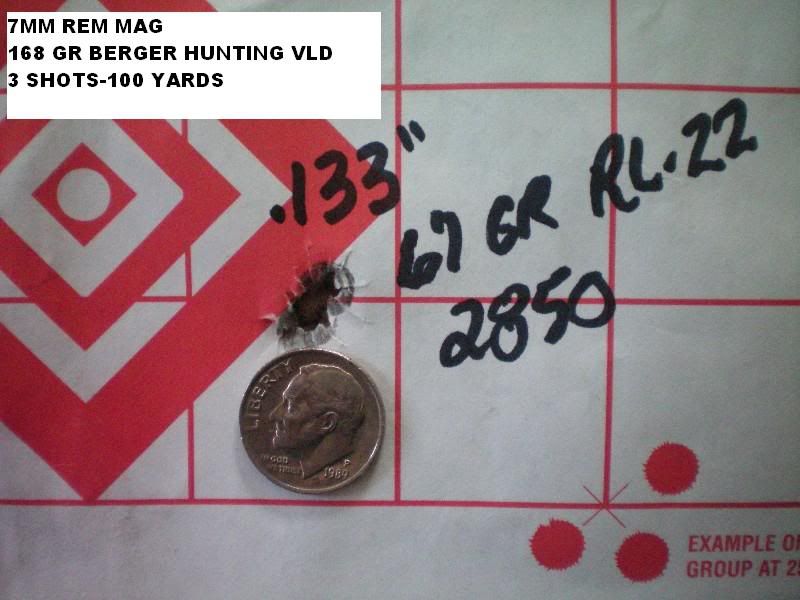

They shoot awesome with handloads. Had a 7mm Rem Mag that would put 3 shots into one hole with 168gr Berger VLDs. Center to center, my two best groups during load testing measured 0.178" and 0.133" @ 100 yards! And that is the gods honest truth.

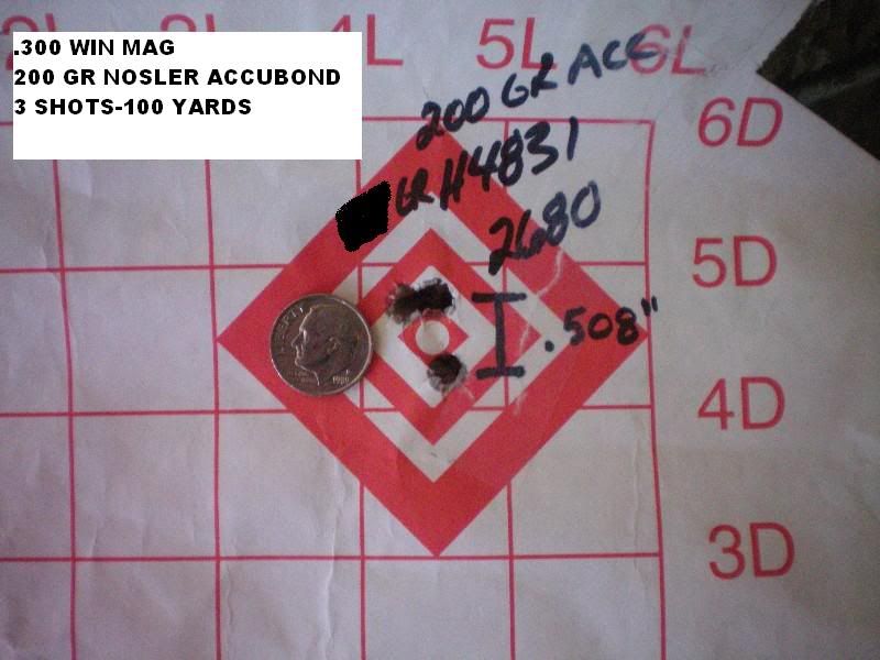

Also had one in a 300 win mag that shot unbelievably well too. Very first trip to the range with it to test 6 different load recipes using 200gr Accubonds, it shot 5 out the 6 groups under 1/2" @ 100 yards.

Here are photos of the 2 groups I fired during load testing with the 7mm Rem Mag Venture using 168gr Berger VLD bullets. Notice that even the difference in charges of RL-22 were 1 full grain apart :)
And 2 photos of the groups i shot with the Venture 300 Win Mag using 200gr Accubonds. Ok, ok...I suppose the one group is a hair over 1/2 MOA :)
