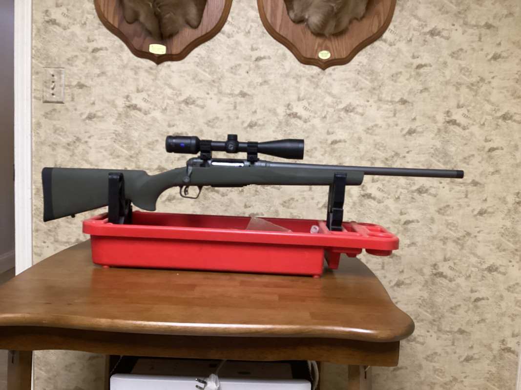

I posted this on a crossbow board, under non-crossbow topics. I recently got a Savage Trailmaster 110 in 400 Legend and topped it with a 2x10 Conquest scope. No brass available, yet; but many excellent 40 cal smokeless Muzzleloading bullets are available for reloading. This tremendous selection seems largely unknown since on reloading forums, I read about the nonavailability of bullets other than pistol bullets.
Below is the post I made. All shooting was done off a card table with quality rests and shot in a farm field with a 45 degree 5-7 mph quartering tailwind . No windage corrections were made.
Parts of Arkansas where centerfire was previously not allowed, SW cartridges are allowed this year. After looking thru all the available cartridges, I selected 400 Legend in a Savage 110 Trailmaster. Almost no ammo is available, period and virtually none in stock.
I bought 2 boxes of Winchester 215g (2,250 with a dismal 0.205 BC). No good brass available so these will be my fireformed cases to measure and use for Quickload calculations. I’ve ordered Redding reloading dies and have 100s of 200 SSTs and a hundred 225 Accumaxes (BCs of .265 and .315 respectively). Should be able to get loads of 2,400 and 2,325 respectively, which will greatly greatly help trajectory, and supposedly accuracy.

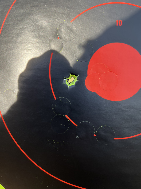

I cleaned, then lapped the barrel ((360,500,800,1200, JB, cleaner). Great improvement in feel and appearance. Mounted a 2-10 Zeiss Conquest, bore sighted and went to the field. Using the trajectory points (hold unders and overs) for 50,100,150 (zero) and 200(5.5” low from 150 zero). I preceded to shoot 2 shot groups( 50,100,150 and finally 200. ALL 2 SHOT GROUPS WERE TOUCHING! The wind was 5-7 quartering from the right to left. I did not correct for this, thus you can see how each of the groups hit farther to the left the greater the range. The 3 red dot hit covers in the red bullseye show this left progression. Finally at 200 yards, the hits moved out of the red bullseye.
This 400 Legend with factory ammo is <1/2 MOA thru 200 yards! Who would have dreamed a factory rifle with factory ammo, SW cartridge could do this! Not me. I think I’ll keep it.

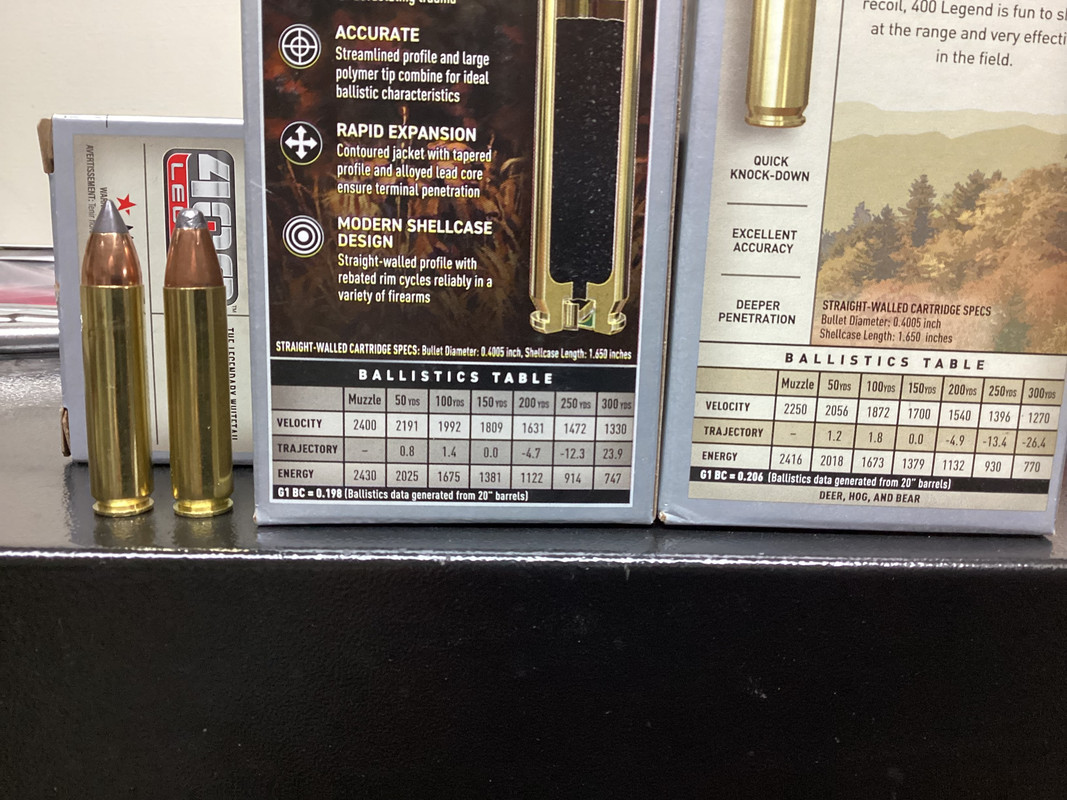

Slight update. I just got some 190g with plastic tipped , more aerodynamically shaped Winchester 400L ammo. Their published MV is 2,400’/sec and slightly increased BC helps trajectories only slightly. The differences in the lead(215g and the spire pointed (190g) in trajectory and energy retained are virtually a wash. Due to high winds, I have not been able to compare actual in the field differences. The 215g, lead tipped, and the 190g spire tipped factory ammo may well be so good that hand loading would bring little advantage.
People hand load for 1 or 2 or both reasons: lower the cost of shooting or, more accurate or efficient loads. I got dies even before the rifle because I was certain I could get more accurate, faster loads. Not so sure, now. Hard to beat <1/2 MOA thru 200 yds. The 400 Legend, as accurate as the Savage appears to be, likely won’t be used as a plinking or target rifle.
Quick Load (limited by the available powders in the program) has trouble even reaching factory velocities even when using fired case volume. Incidentally, the 190g Winchester bullet is virtually identical to the Hornady 200SST.

The tip on the pointed bullet is actually black plastic. It looks the same as the lead tip on the right but, it isn’t.

I’m afraid that lighter weight, 40 cal bullets will not result in higher BC’d bullets. Sectional density is the factor.
Just look at the 2 Winchester factory bullets. 25g less weight (215-190) even with a spire point actually resulted in a lower BC (.198 vs .206). The increase of 150’/sec for the lighter bullet was virtually totally offset by lower BC to where the actual trajectory and KE remaining were almost identical to the 25g heavier but less aerodynamic bullet.
With these comparatively heavier than normal CF bullets plus the larger than standard CF caliber bullets, momentum starts playing an increasing factor in lethality compared to KE.
The answer, imo, is much higher BC’d bullets such as the 225/228g Pittman AccuMax bullets (BC .315) and being shot, hopefully, @ 2200’/sec. Note, the Winchester velocities for their 190 & 215g bullets are very high when considering case capacity, bullet weights and maximum pressure. I suspect either commercially unavailable or duplexed powders must be used by Winchester.
Going to be hard to equal or beat the Factory loads.
