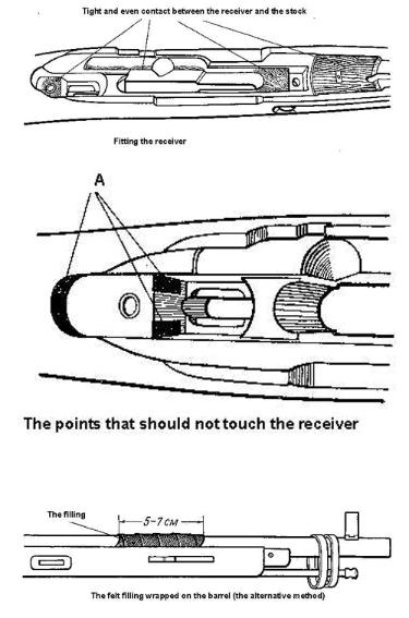

Here is your english translation of the accurizing page. There more info on 7.62x54r.net then any enfield website.
