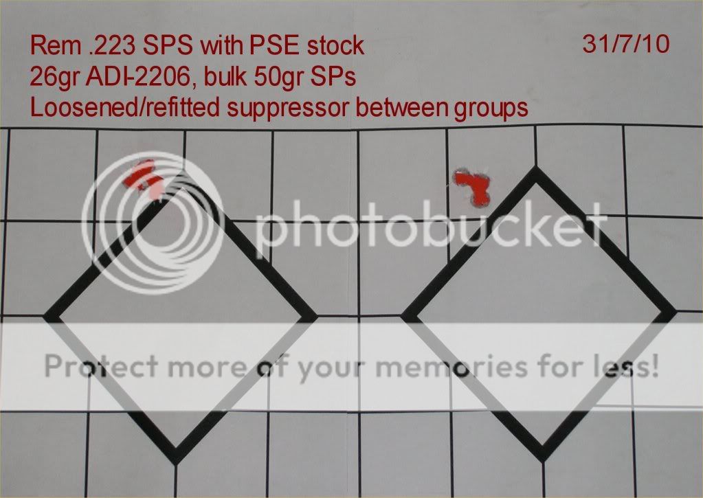

This is two groups shot with the suppressor loosened between them.
The POI shift is pretty minimal but it was -way- worse before the contact was relieved at the back end

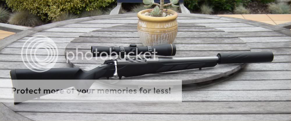

Actually having my 7-08 hunting rifle suppressed as I type. Hopefully ready next few days. Going to have one of the special models NZ Hunter got Hardy to do for their Bush Pigs. The T3 Lite will end up no longer and barely heavier than it is standard. Despite the much shorter barrel, we know that H335 with 120TTSXs will still produce 3000fps and that ain't a squib loading..
Chris-NZ

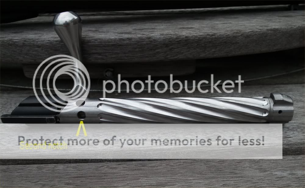

Collected the T3 today- suppressor fitted, bolt spiral fluted and a second "half cock" notch that allows the safety to lock the bolt tight with a round in the chamber.
Total weight with the 30mm scope and (heavy) Optiloc rings is 7lb 11oz. I intend to fit my spare 1" 3-9 Monarch and lighter rings so she should then come in about 7lbs flat.
Sighted it in quickly this evening with 110 TTSXs, a temporary measure while I await the 120s, and they're doing 3050 using H335. Definitely up to a sika, one of which I hope to tip over this weekend.
