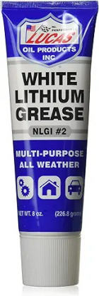

I have had the most consistent results with white lithium grease on suppressor threads and pistons.
The stuff works. Use with some moderation and wipe off any excess.
