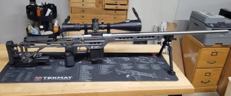

A 224 Valkyrie custom bbld action. Its a keeper.
A 6.5 CM custom bbld action. Which I just ditched to build...
6mm Dasher. Douglas bbl.
That rifle should be capable of 0.25moa all day. If you can’t attain that in the first 200 rounds by tuning the rifle, possibly the barrel is what many shooters call a junker. Not all barrels shoot lights out. In fact, only 2 out of the 10 custom barrels I’ve put on F class rifles were true shooters. The other 8, I constantly felt like I was chasing a good load that would come and go with what seemed like complete random nature.
