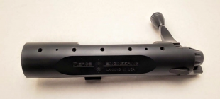

One of, if not my favorite cartridge is the 338 Lapua improved. It will blow you away with ease of tune and raw accuracy. I highly highly recommend it. You cant beat the Bat ignitor for value in a properly designed action meant for this case. But also look at the Bat HR and Borden bigfoot. Personally I like them as single shots. An HR or Bigfoot single shot would be nice. Now, if your planning to go heavyish then Bat M in a McMillan A5 BR tang stock. Thats the only stock that fit br actions, other than actual br stocks. 30" HV barrels run 300s over 3k fps and I have shot 1s at 1k with everyone I have owned. Just crazy how they shoot. If it was not for the 10 shot groups I would have built one for 1k br.
If you want a factory action some of the large Weatherby actions have a Lapua sized bolt face. Mine is built on a Sako TRGS, mostly the same action as the TRG42 but the sporter model. I would guess there are others I don't know about.
