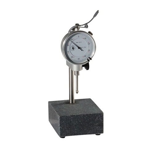

Thanks when I brought up this ( https://www.brownells.com/reloading...air-bullet-sorting-stand-with-dial-indicator/ ) I read as follows..
"The Sinclair Bullet Checker Stand allows you to quickly and accurately sort bullets by base to give length."
That reads as some bad AI speak to me. :)

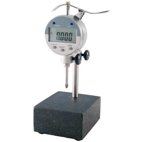

Hey guys, thought I would chime back in here. First off thanks for all the suggestions on different tools.
I'll show yall what I ended up with. This is just something I cobbled together. Sorting bullets is something new for me. Seeing I have no idea if it's going to effect the disciplines I shoot I was hesitant to spenda bunch of cash.
So.. I picked up a cheap base off Amazon. Ditto on the cheap digital gauge. I'll use my bullet comparitors as well.
So thanks again guys.

Do you pull up on the top stem to give enough room to put another bullet in?
