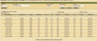

IMO that's a little hot for a starting point with the 6BR.
According to Hodgdon on-line data, starting at 29.2 gr would be ok except for bullets >90 gr (and a 62 gr BAR VG).
I don't see where the OP stated what bullet he was loading.
Nor do any of us know what bullet he is loading. But the Hodgdon data is for 6BR Remington. We also don't know if that's the 6BR cartridge he's shooting. If his bullet is long enough to generate a chambering conflict it's likely he's loading something heavier than 90 grains. My goal is to make certain he's got all the accurate data necessary to produce a safe and successful load.
