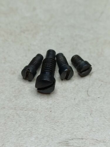

Success!! After two weeks of soaking, I used the drill press method. A lady at homestead firearms showed this trick to me. Chuck the correct size screw driver bit in the drill press. Put constant pressure on the screw to be removed and turn the chuck by hand. On very large screws she uses a pipe wrench on the chuck. Now you can see in the pictures the gum that was on the screw.
