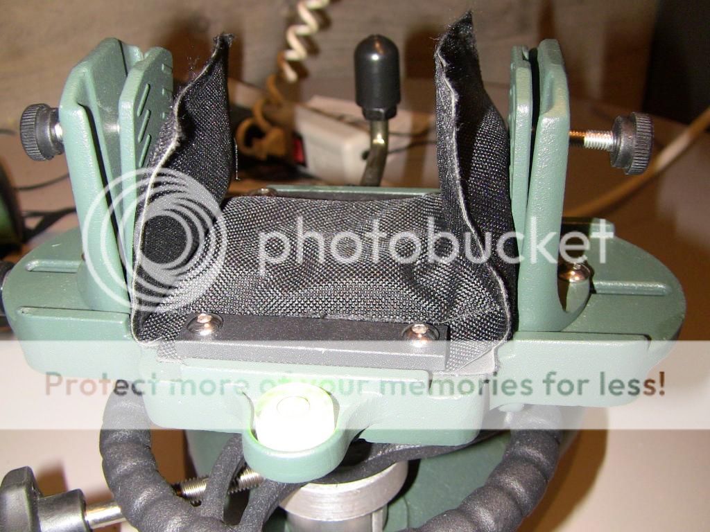

I know nothing about Caldwell bags, but is there anyway you can get more sand in the front bag? It looks as though your stock might contact the retainer screws......and it is grossly underfilled.....wrinkles are NFG.
yes lhsmith i have already done that thanks buddy pic was done after i hurriedly filled just to show what i had available afterward i used an old old dowl rod and pressed the sand down so more could be poured in it is pretty plump now lol no wrinkles and i agree nfg
i got it filled and it seems to be pretty decent i have never seen protektors codura bags so i can't compare but it is not bad but i intend on contacting protektor tomorrow i will let them know what stock and rest i have and buy the best two bags for that combo i really need help in the tracking area
