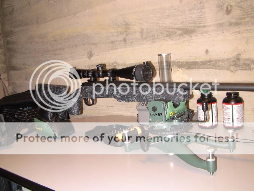

stock looks and feels great the barrel and action are still stock but i have also replaced the trigger with a calvin elite the scope is a sightron sii 6x24 i bought off the classifieds in this forum thanks for the help guys
this flat bottom of the for end is what i like best about it after the aluminum bedding that is i hope that this means i wont need to glass bed the action

I really suggest you replace the front bag on your Caldwell rest. You need one that fits the stock better, like a Protecktor. I would purchase a better rear rest too...notice how round it is on the bottom? It will shoot okay but you will shoot better and more consistently with better bags.
i appreciate that and i have had that problem and was told by my friend that is instructing me it was a problem i just bought that rest so i did not know but i will replace them soon thanks and keep'em coming lol

The rear bag is backwards in your photo setup ... and I 2nd upgrading front and rear bags. I believe a 2-14" wide Protektor front bag would be a much better fit. Note how your front bag does not allow your stock to contact the fore-end stop on the rest.
For a rear bag , call Protektor and tell them the details on your stock ( i.e cheek piece? rounded bottom? ) and they will get you the proper one. Also, I always remove the swivel studs for bench sessions.
the rock that i have came with a smaller front bag that was not filled does anyone know if it is worth messing with or should i just go ahead and get protector also i have been using this bag but not backwards this was just a quick throw together to take a picture lol thanks for all the help guys i really do appreciate it
