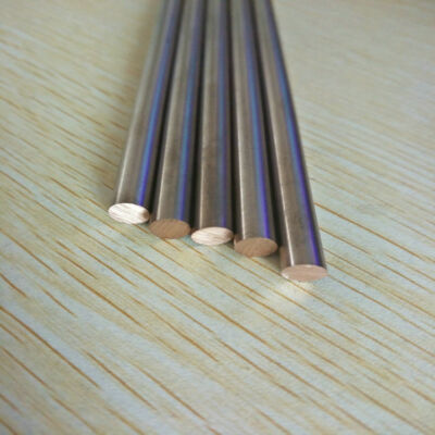

It would help to know the rifle specs and what type of competition. If cutting down the barrel length is not an option, consider tungsten carbide. It is almost twice as heavy as lead.

Tractor Supply or "other" purchase two 1" bolts saw to 2.70" length, push in hole and see if it helps.. Or..
Two of my HG used for 600/1000 yard BR are weighted in the butt of the stock.
One with lead poured in a section of 1' OD steel tubing and he other is a tungsten bar 4.25" in length.

A condom will fit better than saran wrap. Tungsten bird shot as small as you can find.
