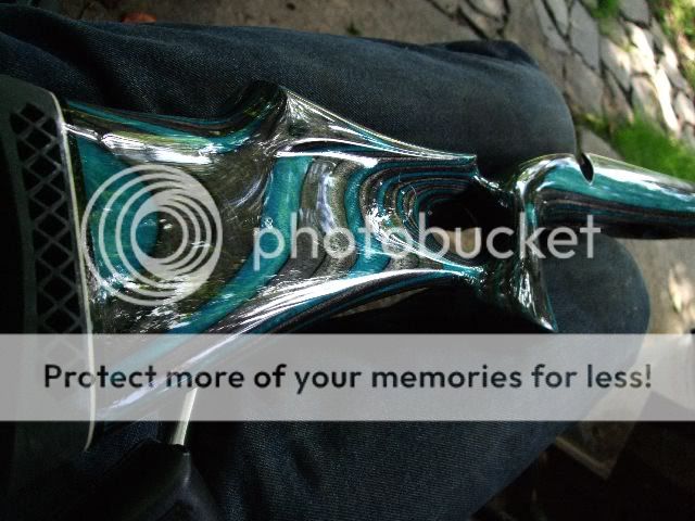

I use Gorilla glue to seal the wood and fill the little depressions, and then apply as many coats of Auto Clear as it needs to make it look like liquid glass..... Lots of wet sanding up to 1500 grit between coats..
A few more coats and this one will start to shine :D
