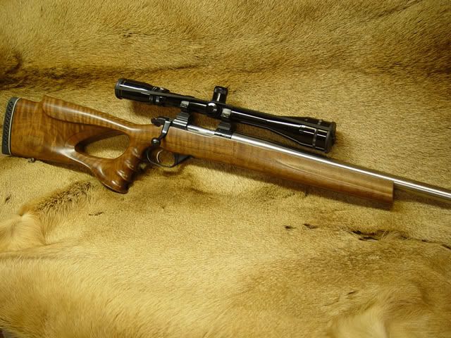

Sorry, just noticed your post.
I built that. I have been making stocks for many years. That is my thumbhole design with the trigger guard moved back into the grip area. It is very comfortable unlike most thumbhole stocks where you have to reach with your finger to get to the trigger.
It is a laminated stock, made with some stripped walnut I got from a wisconsin tree.
Until recently, I made of few custom stocks a year, but the demand got out of hand and the hobby that I enjoyed became a chore, and I get more than my share of stress from my job. I don't need any more from outside.
I may in the future make a couple stocks and offer them for sale for certain actions, but the custom work is out for now.
Jim
