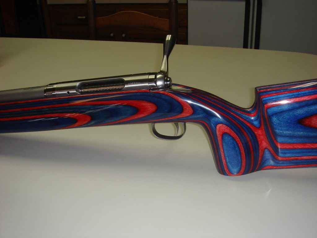

Below, one of the few closeups I have of a stock with the epoxy clear. I don't wax them as they get too slippery. I just wipe them down, but if they were waxed, it would definitely be a difference.
JMHO, but I don't think there's a better, more durable, or practical finish for a rifle, than automotive clear.
