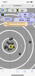

Where is shot 19 on paper in the attached pics.
I have rarely shot at a 6 target+ match where one target wasn’t acting up and you hear people say. “it will be ok”…. “It can work with 3 mics”… “take another one” … “ignore that ghost”. “those messages are ok, keep shooting”.. or things like that.
we need to know from the manufacture what messages, if any, are ok and what is a stop shooting and fix message.
