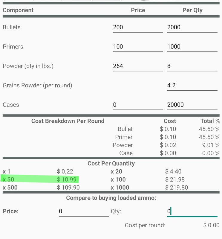

Today's cost with new components for my 9mm loads is $11/box of 50. They are super accurate!
9mm
124 Precision Delta JHP V2
4.2gr W231
Any primer
Mixed brass range pickup
Ten @ 25 yards.
