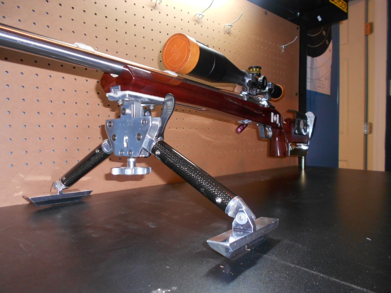

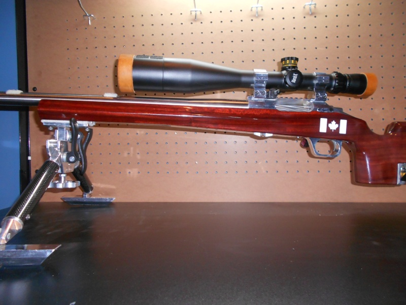

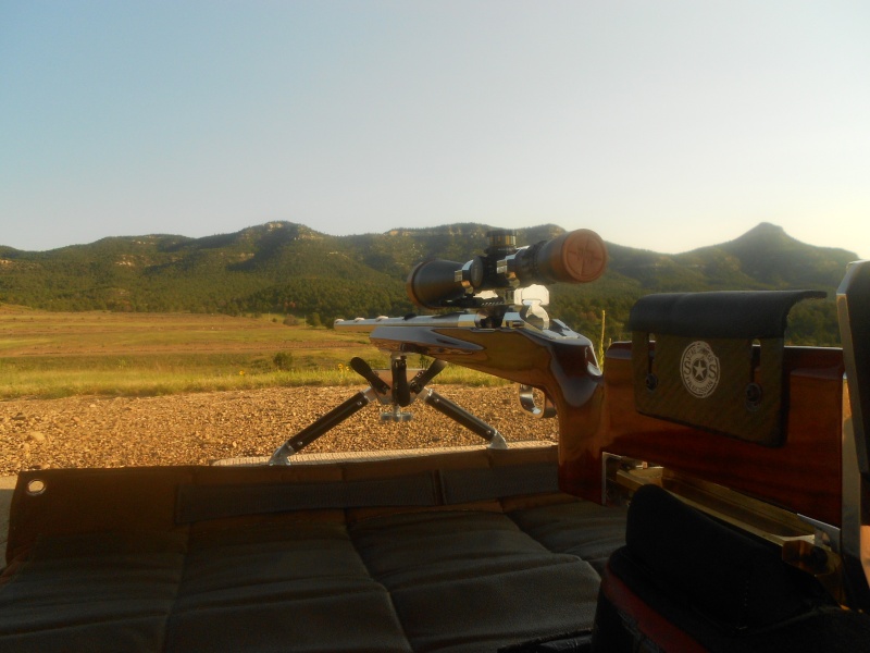

so here is my first post on this incredible forum that I've been learning sooooo much in the past few years. This year was my second year shooting at a 1000yds and manage to find a spot on Team Canada for FCWC at Raton. Here is the rifle that brought me there:
StarShooter ultimate FTR African padouk stock reinforced with carbon fiber
Kelbly Panda F-Class action RB-LP
March 8x80x56 c/w Kelbly rings
Bartlein 1:11, 34in heavy palma barrel

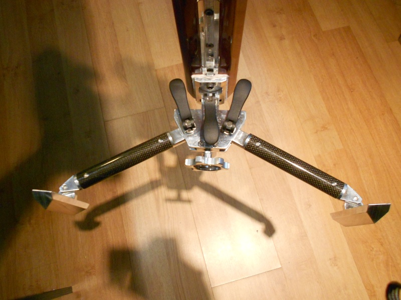

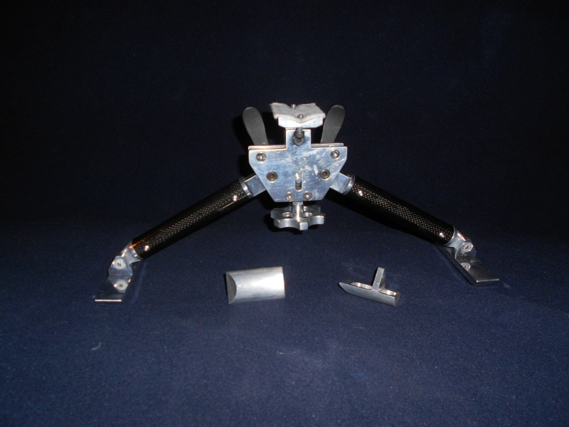

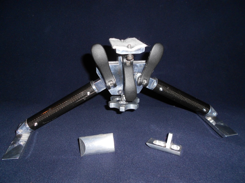

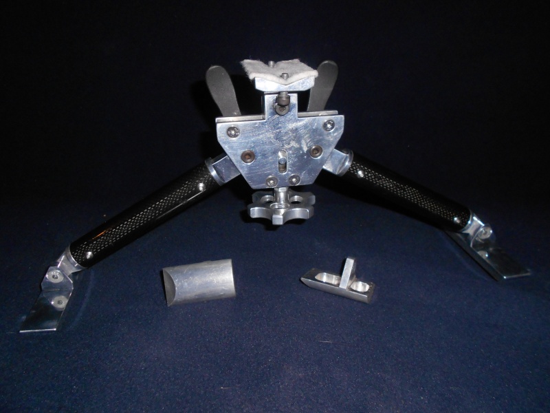

StarShooter CF-SS light weight bipod (23.2oz), custom bench feet installed presently

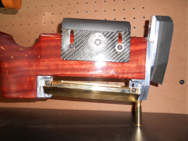

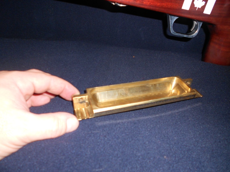

total weight of the rifle is just 1oz under with a 24oz flat brass adjustable piece at the back
thanks for looking

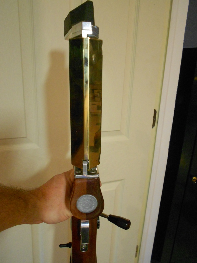

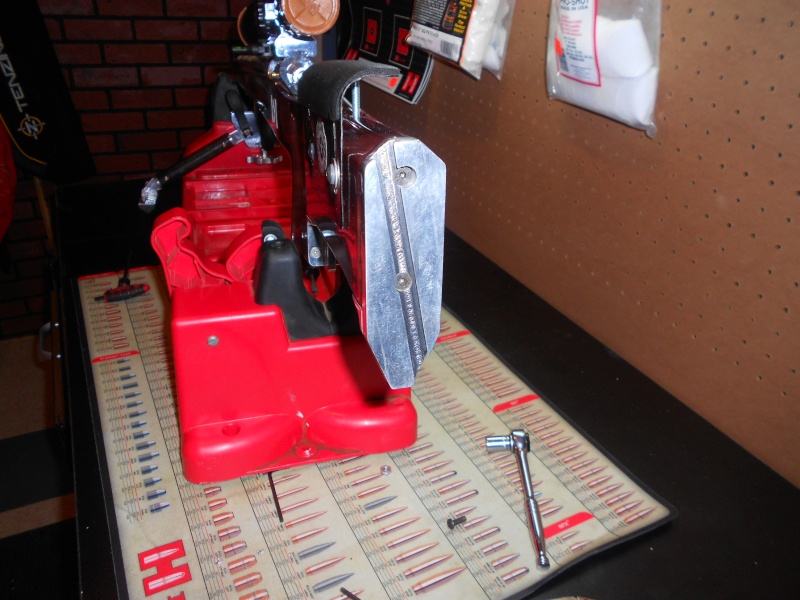

18 pounds - 1 once c/w bipod

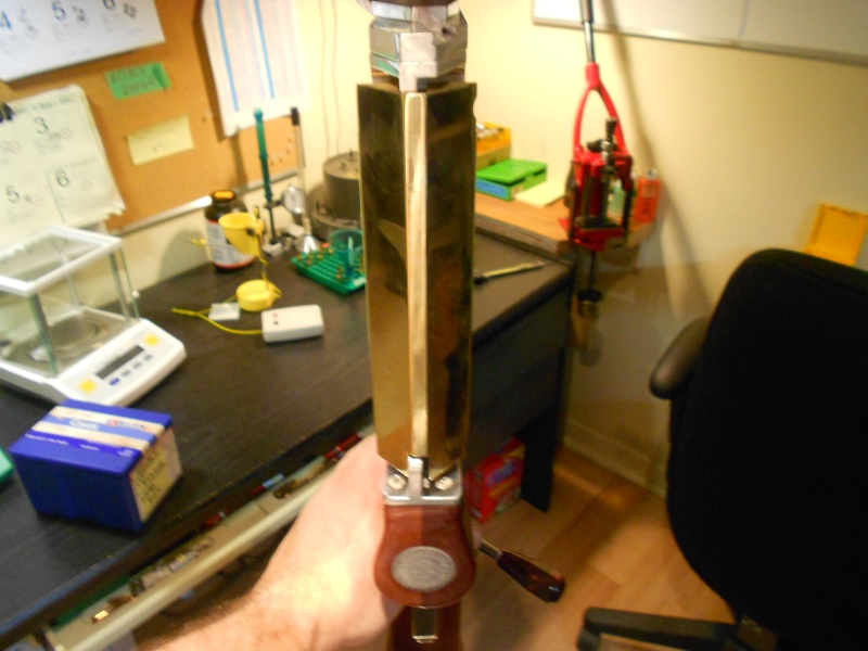

the last piece that was put on the rifle was the flat "guide" to ride the bag which was made out of available weight left. It was modeled in 3D then machine afterwards.

The reason for choosing african padouk is that the weight of the wood is the same as maple but 45% more rigid. Here is a link where we can look at different wood specifications:
http://www.bellforestproducts.com/padauk/
I would have thought that maple would have been a better choice for you. It would serve two purposes; rifle stock and maple sap producer in the off season. :-)
you are putting your finger wright on a problem that is still not fixed...but will be soon. The rifle been coated with a urethane car clear and looks outstanding in some part but there is bublesss in some other. As StarShooter is always behind is product, he will re-clear the rifle this winter with a different procedure that for now, I don't know of (need to talk to him).
