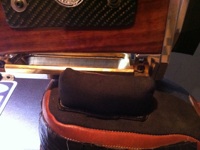

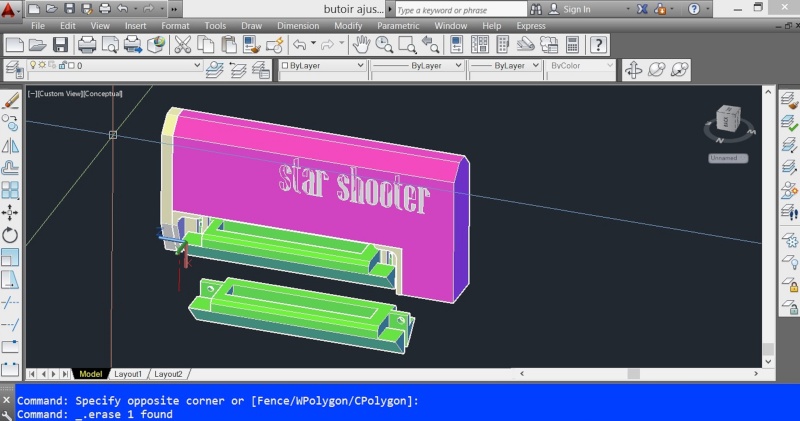

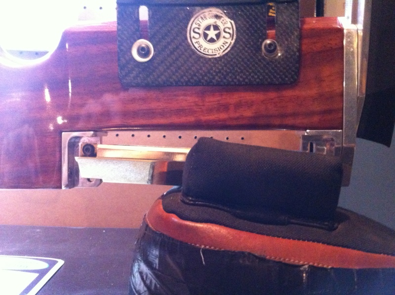

so here it is....some pictures with more detail of my rear adjustable. It is made out of a square brass bar of 1 1/2" x 1 1/2" x 6 1/2", machined as per detailed 3D model. It came down to 23oz, same weight as the bipod and this is no coincidence !! The width of the flat at the bottom is 3/8" wide, the same as the stiches. I had to remove sand within the ears of the bag to make it "sit" properly.

I do agree that the rear bag would require some adjustment to match perfectly the system. I would also consider lower ears as they are too tall for nothing.
The way it tracks presently, I don't know what I would gain with any adjustment. Its really like a open gun. The cross hair to even go out of the 10 ring after the shot (with proper body position of course).
