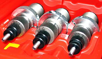

Stardard press bullet seater vs arbor press bullet seater
You forgot the cheap bastards like me who buy the Forster benchrest seater that is the same thing as the Redding seater. And greatly reduces bullet runout the same amount as the Redding seater for less $$$$$.
Forster Benchrest seater $54.99
Redding Competition seater $95.99 - $189.99
Below the Forster seater uses the same type die chamber that holds the case and bullet in perfect alignment.
And don't believe anything Dusty Stevens says, below is one of his reloads with minimum bullet runout. :rolleyes:
Just kidding, the above image is a factory loaded cartridge that made it through their quality control. :eek: (and why we reload) ;)
They make a tool to straighten those. Looks like a forster die loaded that!
All things being equal(which they usually aren't), the fundamental difference between the two die types is this: Wilson dies and an arbor press push the bullet down into the case neck while press type seating dies have the bullet sitting on top of the case neck and riding it up until the bullet is stopped and the case neck is pushed up around the bullet. Both concepts work fine. I just like working from the pointy end of the bullet so I prefer the Wilson seating dies and an arbor press.
Runout is not induced by the seating die unless its just not even the same caliber. The runout is there in the brass before you get to that point. So if you have a 6br just call wilson and get a 6br seater. Theres no need for going all out on getting it fitted or whatever. I use a dasher seater for all my 6br needs with no issue
I agree. Absolutely. Run out comes from the brass. Period.

That article is why I bought my Redding Competition Seating Die.
You are correct. And I am trying to do things correct because I wasted to much money the first time around buying the wrong things. So 8 months later, I will take a loss on the wrong items to try to get the right ones. Even if it means buying an item beyond my abilities. Figure I’ll grow into it;)
Don't feel bad I've spent a fortune on dies always thinking something else is better only to find out the new high dollar item is worse that what I had been using. Focusing at your original question you will be hard pressed to find a seating die that will out perform your Forster used in the right press.
I do like a Wilson seater and arbor press for my small stuff, 17 AH, 17 Mach1V, 22 hornet. Once you get me into bigger cases like the Creeds/243 size cases with no turn necks I prefer the the Forster Micrometer over anything else I have tried and own. My first one came off a prize table so I didn't have to reach into my pocket to try it. I already had a Wilson with micrometer top and Redding Comp seaters for the same case. I'm not making any claim to fame or recommendations here only stating my experience
