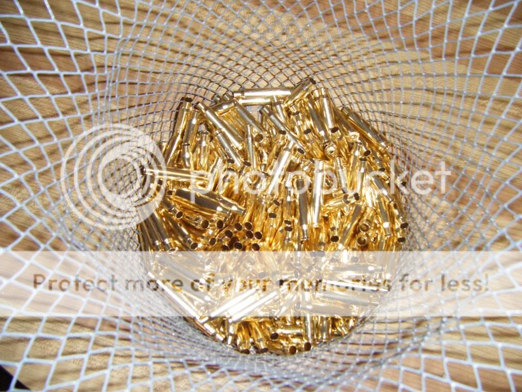

I love the stuff. Completely given up on corn media unless I want to clean a batch of new bullets before coating with hBN.
The wet method stainless media cleans brass inside & out in about two hours, even brass that's been fired & cleaned many times before but not as well.

Don't leave them tumbling too long 20 minutes and they are already 90% clean and ready to go and about 2 hours total to super-shiney new condition with primer pockets spotless.

Still does a super job of getting the cases in clean and like new condition. ;)
