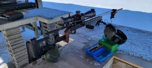

Finally made it to the range this weekend and ran a ladder test with the new StaBall Match powder in 6BR.
Archimedes action from ARC
Osprey Barrel Works 1:7 26" by PVA
No turn chamber with 95 TMK at .050 jump
New Lapua brass, CCI 450
Started at 31.0 and ran up to 32.2
Speed topped out at 2,911 with no signs of pressure. I feel it has more in it. I'll be loading some more up and hopefully testing this weekend.

where is the target. it aint a ladder with out target data...
People are confused because of the terminology. A "ladder test" means observing how the vertical impact point varies with velocity. The term is used to describe a method figured out by Creighton Audette ages ago. If you plot velocity vs vertical impact on a chart, you will see a stair-step pattern if your rifle is sufficiently accurate. Hence "ladder".
