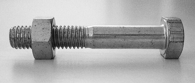

I just had one today in my 45 Colt. For hand guns, I get a bolt that looks like this. The unthreaded part has to be long enough to push the bullet out of the barrel and about 2/3-3/4 the diameter of the bore. I cut the threads off so I keep some of that radius where it transitions from no threads to threaded, then file the radius smooth. I wrap it in heat shrink or tape and use it to tap out the round. Normally, I point the gun barrel down and swing the gun to hit the head of the bolt on an anvil instead of using a hammer to hit the bolt head. It took a lot to get it moving, but once it did, it came out pretty easily.
