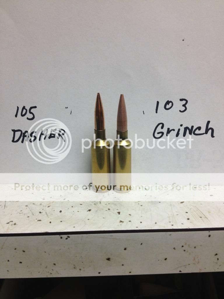

Splain me this: Grinch VS Dasher
Parent case for the Grinch is the 6.5 Grindel. so your first dimension you need correct is the boltface of your rifle. It requires a PPC diameter boltface.
So please 'splain to me what the heck is this grinch?

I found a Grinch/Dasher pic I like better!
