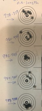

Rainy weather had me indoors so I sorted some ammo to try my own 'scientific experiment' I'll share my findings.
Sorting
I sorted 22LR by overall bullet and casing length. I did not weigh and I did not sort by rim thickness. Measurements in inches with a digital caliper.
Ammo
Popular brand of target ammo was used.
Ammo varied from 1.000 to .967 = .033 thousands total variance
The most common lengths of ammo measured from the boxes was used. Most of the ammo is .984-.985
The rest of the ammo I marked 'barrel warmers' and will use as such.
Target Setup
50yds - 5 shots at each - very light to no wind - 90 degrees
Target ring is 1" diameter
So is this picture telling us that changing bto will help with horizontal with a centerfire?
