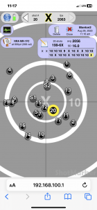

I use Aztec code 166 on my necked up 6.5-284 Lapua brass with the necks turned to .014”.
Anneal every firing.
Loaded neck día is .312”.
A new bullet doesn’t drag on the neck ID of a fired case, with the chamber neck bore at .315” which suprised me a little. That’s only .003”. My theory is that I want the neck as tight as possible to the bore, and still have a clean bullet release and get a good pressure seal between the brass neck and the chamber.
I still have too much vertical at 600, but I think it’s more the tune than anything.
