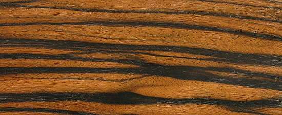

Macassar ebony.

+1 for macassar ebony I have some that has more of the dark color and less light color makes really nice forendtips and grip caps
