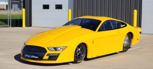

Yep, we've built a lot of pro stockers over the years and you have to be within a tight circle to get any meaningful information. The money it takes to make a run at the championship for just 1 car is mind-boggling. We currently build all the cars for Elite Motorsports...........it's quite the honor. Here's a pic of the latest 1 for the Cuadra'sFB_IMG_1714496865422.jpg

Are you with RJ Race Cars?
Thanks Al
