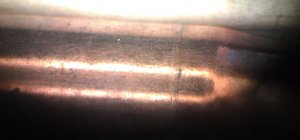

Well I have 5 pieces of loaded ammo that some one has sent to me for an analysis The ammo was the kind that had the said "popping noise" when resetting a bullet. I won't say there names I'll keep that secret unless they want to disclose themselves. But everyone should give a big hand to that person, I have been asking for the problem ammo to be sent to me for over a year now.
Ok down to business, I just received the ammo so not all testing is complete yet, but I had to start looking for a cause, it is very exciting. I have enclosed some photos not the best but they do show signs of what is going on and I will explain some of it but not all. If you want to know more you will have to pm your number to me and I will call you and chat a bit if you want.
First the brass was in normal condition and the bullet also . The first issues found was some embedded copper jacket into the brass that had torn from the bullet and stuck to the brass cartridge, they ranged in size from 15 micron to 30 micron and obviously freshly torn. The second issued found are a couple of cylindrical rings protruding from the brass and a depression into the softer copper bullet jacket. Other items found were some carbon deposits and some sort of crystallization of a unknown product at this time. Last but not lest the base of the bullet (boat tail to be exact) had oxidation on it, mostly caused by the chemicals found in the powder. Now most powders have additives to prevent oxidation from occurring how ever does not eliminate the possibility. Also double based propellants have NITROGLYCERIN in them, and contain ingredients that range from slight to strong oxidizing properties.
The small particles of copper jacket were removed from the brass and examined for any kind of fusion, the so called "cold fusion", NONE WERE FOUND. The brass and copper were simply latched together with very small protrusions in the brass embedding themselves into the softer copper jacket creating a "Shear effect" when resetting the bullet. It would be correct to say that over time as the brass contracts back to it's original state after sizing a mechanical bond becomes more prevalent.
Currently I have several thoughts on this matter. 1st, unless the bullet and brass are polished to a perfect less then 5 micron surface one may never be able to prevent this occurrence from happening. 2nd the act of polishing the necks with a copper or brass brush after sizing just before bullet seating may reduce the effect but not alive it.

Exciting indeed – thanks for sharing your findings. A few questions.
First, did the unnamed donor send you any control ammo i.e. reloading the same manner but more recently to compare?
Second, did you have a chance to do a firsthand seating force determination i.e. with something like the K&M tool to see if they actually seated hard and with that popping noise.
Third , the cylindrical rings protruding from the brass, were those donuts?
I had five pieces total all loaded at the same time about four years ago. I did do a force test on compressing the bullet back into the case on the other samples. My lab tech reported and avg of 175 pound forces to compression. Yes the ring was all the way around the brass and bullet.
The photo below is the case neck

The ammo tested/ examined was one that had made the popping nose. The results are stated above. The others used for testing pressure did not render any spikes in the pressure curve.
Further more one can not teach the blind to see colors regardless of what you do. at this point you can continue to call it "cold welding" but you will be wrong, no signs of a Cold fusion bond EVER took place between the brass case and copper bullet.
Boyd now we all need to come up with a correct name for this occurrence anything other then "COLD WELDING"

The big find here is that this particular round did not have a cold weld to it, nothing was fused together except for in a mechanical state.
The reason that I put "cold welding" between quotation marks was to indicate that while that is the term that is commonly used to describe the topic under discussion, that I was/am not trying to say that actual welding is what is taking place. It would seem that you have wasted your condescension. I don't claim to have actual knowledge of the mechanics of the attachment, just experience with its characteristics, and a successful method for avoiding it. The term cold welding has been used by multiple sources to describe this for decades. I was merely conforming to custom. Some of the posts in these discussions indicate (to me_ that the writer is making conjecture about something that he has never experienced, and therefore has no direct knowledge of. If you heard poppling when moving sample bullets, you have that experience. It is just too bad that the rounds were not in a position so that the force required to make the bullet move as it popped would have been recorded. Perhaps another time.

Several things are very clear after testing even the small amount of given ammo. It does happen! And know we know at least one reason in particular ( PROTRUSIONS FROM THE CASE NECK BITING OR LOCKING INTO THE BULLET)this is obvious seeing one can see the shreds of copper left behind, and there is some kind of corrosion taking place (but not exactly effecting the bullet neck relationship)
