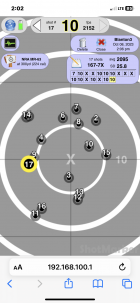

The 77SMK shot well for me today from a 20” Bartlien service rifle bbl at 300 yards. Very windy here with a 10 mph gusting to 15 from your 7-9 o’clock position. Dunno where the first sighter shot 7 came from, might have been a cross fire cause it whacked my SD. I took it and one sighter for a 10 then 15 for score.
X ring is 2.85”
10 ring is 5.85”
