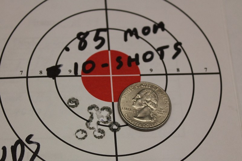

I use both 77gr smk and have 2 different loads at 2 different seating depths . They are both for AR rifles but were worked up in two different rifles . Regardless I'm stuck with mag length so one is at 2.255 avg which put's some right at 2.260 and others at 2.252 . The other load is seated to the cannelure and crimped at 2.250 and is designed to replicate-ish the 5.56 MOD-1 load .
I think this is 23br IMR 4895 from my NM 20" AR @ 100yds . Sub moa 10 shot group with the two flyers from an AR is gtg for me .
SMK's are pretty jump stable so really what works in your rifle best is what you're looking for and you may just need to chase it for awhile . I agree with others who recommend the 80gr smk if you can seat long and are shooting more then 300yds .

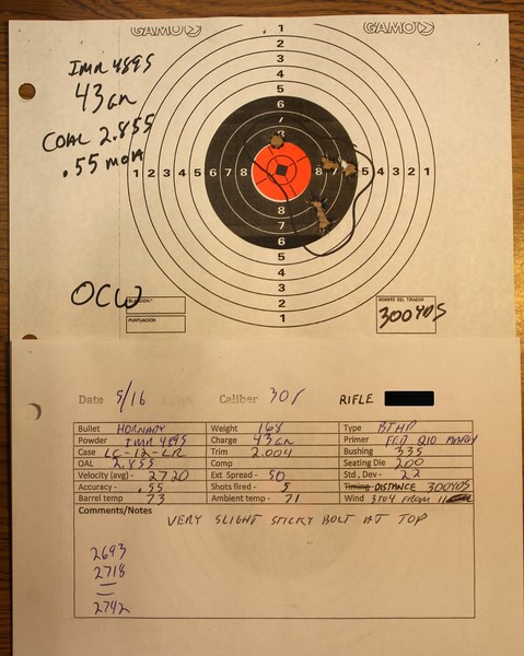

Lately I've been playing around with starting jammed in the lands .020 with 308 TMK I have no conclusions on that load yet . I have another 308 load that likes touching the lands in my Savage rifle . Poor ES/SD from back when I held the rifle to tight to my shoulder but still almost 1/2 moa at 300yds
