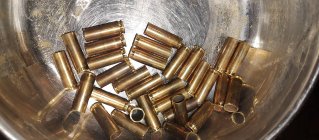

Couldn't you just working intj the chamber design not to need to neck turn ? I mean that's what KAK did with their .17-5.56. all I dowith that one thing is anneal then go from Lee a gutted lee .223 due to the .17 cal die.
I mean yeah you'd have to cut it but I've been playing with making .22 TCM brass. And it's about as hard as .300 blk once you get the measurements

Once you learn to make your own brass from a parent case you dont have to rely on anybody for cases its exactly why I make my own 20VT cases now that 221 fireball are so hard to come by

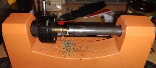

As regards use .223/5.56 brass:
IMHO -I'm not convinced you can avoid the need to either inside neck ream, and/or outside neck turn ? The lower you go on the case' sidewalls... the thicker they get. That trends to make fore-shortened bottle-neck wildcat cases have thicker neck walls after they emerge from the case forming die, than say.... a wildcat formed by necking-down just the neck portion of the parent brass.
As regards the neck-down process:
You'd be best served doing an anneal before cases see the forming die(s). If you want to form the wildcat by runnin' .223 brass directly into a .17 calibre die, you'd be counting on the ability of the brass to neck down into a large" stovepipe ", and thereafter receive a cutoff & trim for length.
*** You may very well find that the necked-down brass' neck
ID is smaller than the desired .17" final cal. That being the circumstance, it may make more sense to do an insde neck ream after case cutoff, while also considering any need for outside neck turning.
I DK how much neck wall thickness you might be contemplating ? An example " 5.6 X 61 Vom Hoffe " case has around .017-.018 neck wall thickness, and a lotta shooters think that's pretty thick; for a neck wall.
I'll try again to send a pic showing the amount of " stovepipe"
I have found that false in my case making 20VT and 17 Badger brass. To many collapses, when I quite annealing before forming i dont think I've collapsed a case.
After forming before I run them through the FL die I anneal.

I said what I said, after my experiences on forming 2 different wildcat cases... each formed to fit chambers cut by running a
6mm Remington reamer in " short ". One wildcat is in the short range benchrest capacity range, and is formed on fore-shortened .35Remington ( Remington
If it works for you by all means do it, just didn't for me.
When I mean making 20VT cases its from 223, same thing making 17 Badger from 30 Carbine.

On the shorter .35Rem- based case, it proved extremely difficult and almost impossible to get cases to come out of the form die; and lubrication was not the causitive factor. I tried case annealing before using the case foming die...and cases could tapped out handidly. That includes the need to anneal ( lower on the case side walls ) a virgin .35 Remington ( Remington brand ) cases.
On the longer 7 X 64-base wildcat, I needed to both a significant shoulder shove AND co-occuring neck-down from
7mm to 6mm final calibre. On this wildcat ( I call DEEP 6 ),
I have would rather easily and frequently encounter striations on the 25* shoulders, even when slowly adjusting the LEE
6.5 X 55 FL die ( intetnals removed ) down in 90* increments.
Again...I'm talking new, virgin brass ( Norma ). After I gave the cases a good anneal to cover the area of the new shoulder's location, striations on the shoulder pretty much went away,
as-long-as I took my time while adjusting the die downward is just 90* max increments.
Perhaps the use of .223 brass would be a different circumstance, but I remain skeptical.
