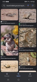

Back in the early nineties I use to go out east of power road in Mesa Arizona and shoot buckets of those little critters, I’m not even sure they are squirrel, look more like a morphed product of a squirrel and prairie dog party but smaller. Back then we used small rifles, mostly rimfire. Now that area is covered in subdivisions businesses and freeways. Sad.

They are called round tailed ground squirrels.

Are these ground squirrels what are also called gophers?
