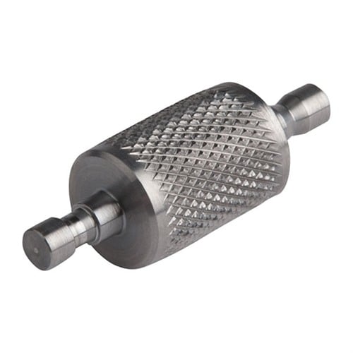

I use the go/no go gauge on my brass as part of my reloading steps. When one sticks to the no go, I put it to the side and then run those through a correction tool made by Henry temple that I have to tighten them back up and usually they last several more firings before retiring them altogether.
