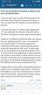

And I completely understand that. The OP of this thread either doesn't set his up that way or he did a very bad job of explaining it.Screenshot_20230325_062910_Chrome.jpg
And the above is what makes no sense to me. Simply smashing a steel die against a steel shell holder with more force and expecting the brass within the die to change size?
I suggest you move on. Use other method. Skip Shims are not the only method; others work equally well perhaps even better for some. I merely offered it as an inexpensive alternative. I've explained the process in detail and don't have any more that I can offer.
I'm sorry I can post a picture; I've never been able to successfully to that. However, I don't understand how a picture of a shim under the lock rings is going to clarify its use. I don't see how posting a picture of a measurement with a bump gauge before and after that clearly show the shoulder has been bumped by using a thinner shim after the initial setup is going to clarify the issue.
You seem to have a problem understanding that if a FL die is turned down beyond contact with the shell holder that the case will receive more sizing. If you read the standard instructions by RCBS for setting up a FL die you will see that they tell you to screw the die down 1/8 to 1/4 turn from where the die contacts the shell holder. This creates a "cam over" condition and increases the sizing. Most of us know that is not a good practice because it results in too much sizing that's why bump gauges are used to set the FL die to a lessor cam over condition to produce the optimum sizing for that die. But the point is that turning the die down increases the sizing up to a point.
