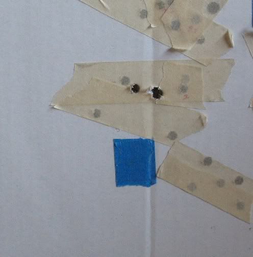

Savage model 12bvss 26 inch factory fluted stainless 243 win. Favorite long range load due to twist considerations (9.25 twist). Is a 95 grain Berger hunting or target VLD jammed into the lands .010" Using Winchester brass CCI BR2 primers and H4350 at 41.9 grains. Which chronos at 3050fps average. with low sd and es. Groups average 3/8 or less at 200 yards for five shots. As well as under an inch at 500 and 3 inches at 1000 in no wind conditions. I have tried lots of different seating depths and powders but H4350 and .010 jam works lights out. But my gun will shoot very well with almost any powder as long as its jammed .010" I use this combo to shoot golfballs on strings at 500 yards at my friends range for fun. This load makes it easy. Matt
