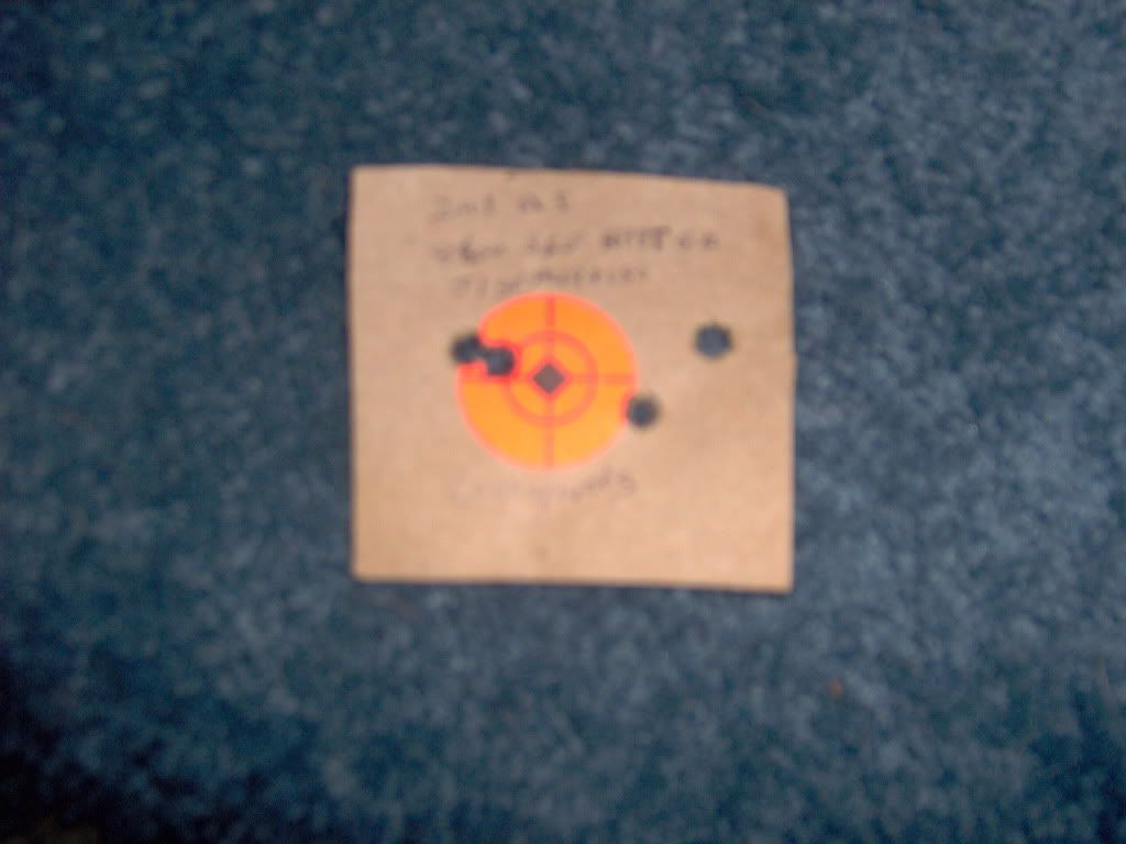

243 win. Lapua brass (reloaded many times), 85 grain Sierra HP Game King (#1530) kissing lands, 2.8 grams (43.2 grain) of IMR 4350, Federal large rifle brass. The rifle is 1909 Peruvian Mauser 98, 1-10 twist barrel.
Re: Site Needs .243/.243AI Loads & Comments
Rem Model 700 VS .243 AI (factory barrel)
Win Brass
Fed 210M primer,
51 grains H4831sc
85 grain Sierra HPBT Game King.
2.72 COAL
No pressure signs...
I dont know the velocity, No Chrono. But best guess by messing with a JBM Ballistic chart after a day at the range is 3300ish FPS. This load shoots very tight groups in my rifle. A 200 yard zero puts me on at 550 Yards with 10 inches of dial up.
Took a deer at 404 yards with this load last season.
Crappy cell phone pic.....
200 yards in erratic left to right wind. ( last 4 rounds after sighting in at 100 yards after changing rings and base.)

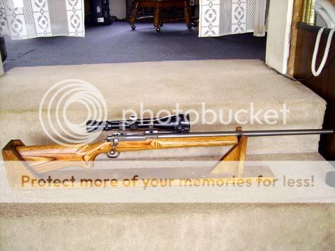

PICTURE SAYS IT ALL
this was 10 shots at 100 yds.
nothing done to the rifle just like it come out of the box.
Ruger 77 mk11 target rifle
