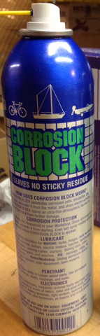

Absolutely. However he failed to evaluate the best corrosion preventative on the market. It comes as a straight oil or as a foamy spray that gets into every nook and cranny. Only the slightest bit of odor. I first got into it in offshore marine applications 30 years ago.
Well I have completely forgotten about corrosion block I am originally from Florida and was boating and fishing my entire life when I lived there that is a great product
I make my own equivalent of Corrosion Block with a mix of 70-90% of ATF and 10-30% of Naphtha, depending on how thin a coat of lubricant you want. Once you read the Safety Data Sheet on these products it is easy to replicate at a much lower cost.
