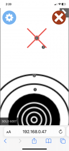

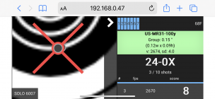

Hmm. No one has heard of the Hood Scope Checker? Charlie Hood built and sold this item few years back. We have two.
You remove your scope and mount the scope checker on the dove tail. Mount the suspect scope on one rail and a good one one the other rail. Fire a shot and adjust the good scope to POI zero, Then move the suspect scope to exactly the same spot. Shoot a few more shots to confirm your zero and check to see if the suspect scope if the two scopes are still properly aligned.
