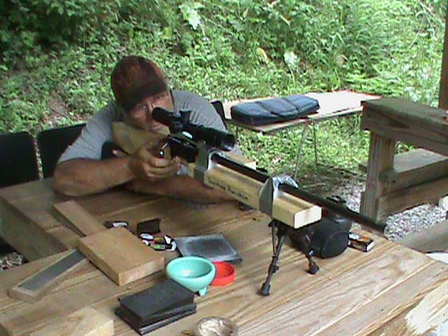

I was told long ago by one of the best longrange pistol shooters anywhere learn to shoot what you are holding and not always have to make it fit you so you could shoot it. I threw together this 2x4 stock for my Win 52-C and have let most of the shooters that have shot my longrange matches at the distant targets. After I got them to forget how it looks and even feels and how to sneak up on it they proceeded to drill my tiny steel plates at 197 yards consistently. They were amazed, by how natural it began to feel when they got over it not feeling like their own gun.
I shoot a lot of different rifles/pistols at the longrange matches and none of them are similiar. They all have different stocks/scopes,calibers and weights but the technique is similiar on all of them.
