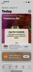

Interesting as it’s still working on my iPhone but not in store?????
Not in the store that I could find and many reports on the web indicating the same. If you search and click on a link to take you to the iOS App in the store you get the following:
