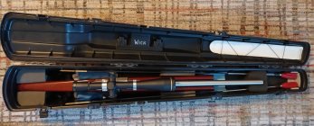

Was gifted an MTM cleaning rod case and it like it pretty good. It will hold 4 dewey rods and runs about $20 bucks probably couldn't round up all the stuff and make one any cheaper lol....
I saw those on the daily bulletin the other day, and ordered one. One of my cleaning rods is about 1" too long for it. Thus..... this little project.
