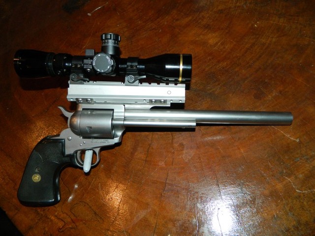

My 252 Freedom arms 22lr set up for longrange rimfire matches with a 40moa mount and bipod/monopod shelf I made and a SWFA 16X rifle scope.

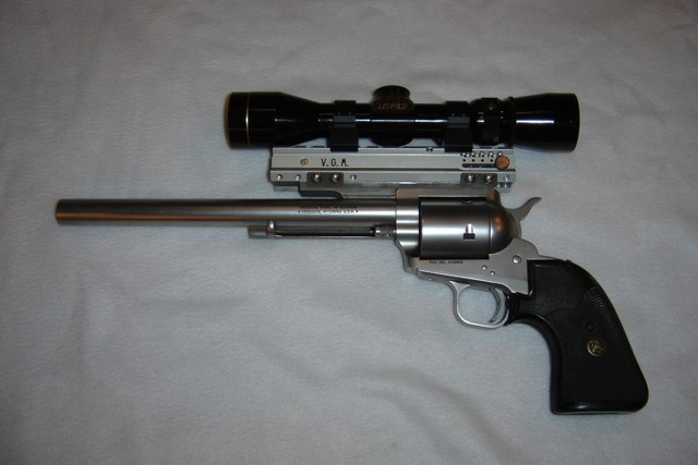

Freedom 44 mag with T'SOB mount with a VGM adjustable mount on top of it (Variable Gantry Mount) and Leupold pistol scope set up for testing longrange shooting out to 500 yards.
