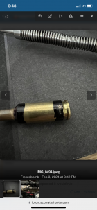

Nothing on the shoulder but have this rub spot on the two piece I tested.

Take a piece of fired brass that’s bumped back 0.002 and confirm that the neck diameter is sized back also. Without the bolt installed, push the brass into the chamber. If the brass body and neck is sized to slightly less than the chamber, it should pretty much fall back out when the barrel is inclined vertically. I’d also take a bore scope and look at the end of the brass at the chamber end and confirm that the brass has “growing room”, a gap and no carbon ring. The sharpie marked case shows contact on the shoulder and the body near the case head. I’m wondering how many chambers have been cut with that reamer and if it has worn and needs sharpening. I cut my chambers to 0.000 or -0.001 so that the headspace gauge fits without barrel torque and bolt slightly drags with barrel torqued because new brass is usually just short and won’t stretch on firing. This requires me to machine 0.005 off the top of my shell holders. It would be nice for you to use a headspace gauge and see how the bolt closes.
