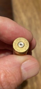

Might want to get the firing pin hole bushed on your bolt. The primers are flowing into the hole even with that light load. What primers are you using? Might can switch to 450's or 205 Federals to reduce the flow.

These were CCI BR4s, so yeah, prolly 450s w/b better. I will try that. I was hoping somebody would comment on firing pin strikes. Thanx.

I just went through this with a 6 BRA built on a 700 action with a PTG bolt. Even using CCI 450s it was cratering so bad with starting loads that I was not comfortable working up loads. I sent the bolt to @carlsbad and had it bushed and the firing pin turned down to a smaller diameter. My primer strikes went from looking like yours to looking like this pic.
