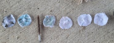

Here's how patches came out after each cleaning:
Note the sequence (left to right) and how the patches showed. 2 wet patches, BoreTech Eliminator, 10 strokes wet brush, 2 more wet patches, then 2 dry patches. STILL getting some blue.

Took the new gun to the range. Specs:
  • Rem 700 action
  • 1:7 28" Douglas bbl (gave it a good cleaning before firing. Very blue patches came out) @Stan Taylor
  • Lapua chamber, measures 2.348"
  • MPA chassis
  • Nightforce NXS scope
Here's the gun:
Loaded up 20 rds 28gr Varget under 105 Berger VLDs. 2.347 OAL Peterson brass. No neck turning required, true Dasher brass. Per barrel makers recommendations, loaded virgin brass light to set primer pockets. Break-in consisted of fire 5, clean for 20 total rounds.
Bolt lift was heavy at times on fired rounds. Here's the fired brass:
